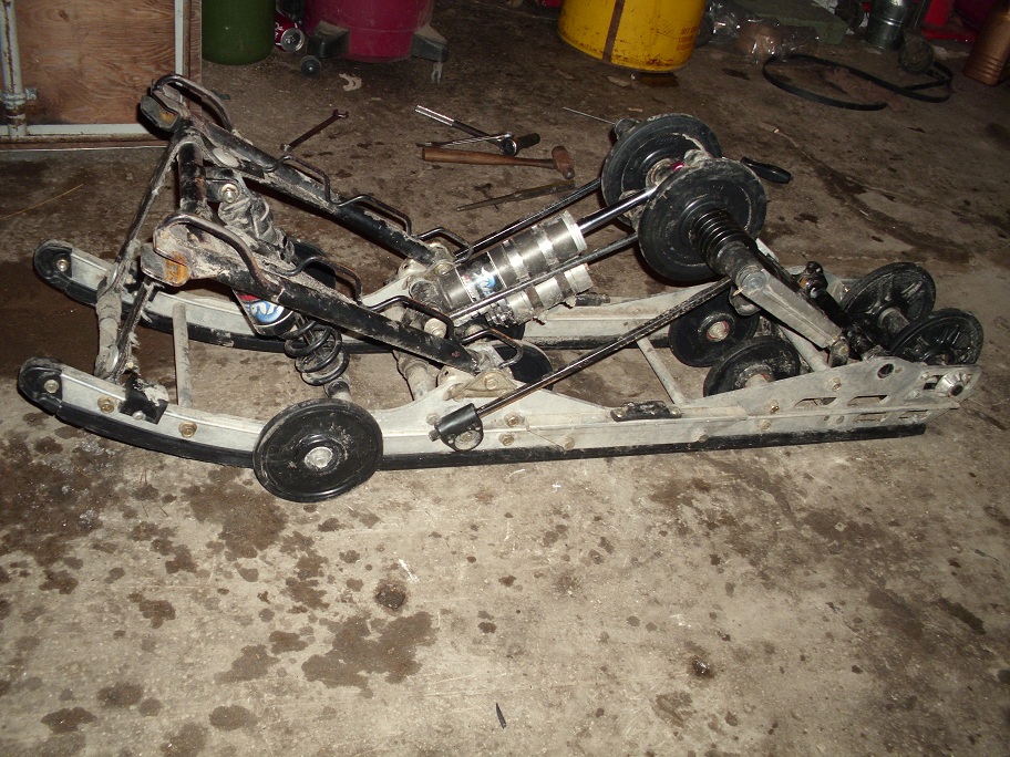

just got new fox zero pros for my mtx skid and wondering if anyone else is using them I think the brass filler valve points down toward track on ground when installed if anyone can confirm please would you or comment on the quality of the shocks thanks
Thats way I would put them in.No experience with them on a Phazer but they work great on Polaris and are a nicely built shock that is easily worked on by about anyone doing shocks.Let us know how they work.How much?

I doubt his have bottles Marp but that is a heck of a skid there!Either way put the valve down so it doesnt get wore off.

cannondale27 said:I doubt his have bottles Marp but that is a heck of a skid there!Either way put the valve down so it doesnt get wore off.
If I turn them around you cant adjust without taking out the skid and taking off the shock (metal blocking it probably will break the valve off). Even if I need to remove the skid it can remove it with 2 bolts in the back and it come out and goes back in in less then 1 min. These shocks have been on there for 1800 miles or so just only being rebuilt and no rubbing action going on. This is the way they come from the factory. The only thing the track touches is the sliders, wheels, and I think the two metal loops on the top of the front arm (U hooks).
Think this skid is heavier then the Phazer but the whole sled is only 450 lbs.

nice skid. thanks cannondale will put them down got shocks from schmidt bros cost me 680$ that inclydes taxes and shipping to canada much less than any other shocks I looked into less than half for the shocks In priced new from stock RTX the price also included him valving them for my weight and riding style. good guys to deal with also.

Thats a great buy!I cant wait to hear how they work valving wise.

I think YAM177 might be able to tell you on how well they work he has used them in the pahzer. Also he has used the Aixs, and Exit.
In the SP they only work well in racing condition for trail riding not so much.
However difference designs in skids will cause different reactions. Also I have the bottles as well.
