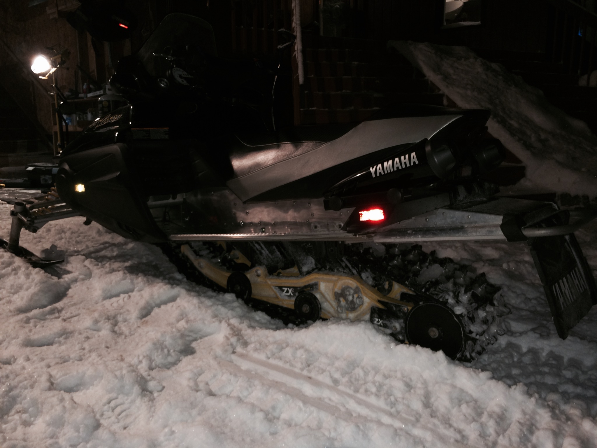

With the sled specific install kit it was a breeze to install …….other than the no-heat garage at -18c
the adaptor kit for the warrior was a must for ease of installation.
runs like nothing i have been on before….incredible, i have the pins at 2/4 but the front end keep coming up too much
when under boost….how do i manage that? it's fun for five minutes but i need to trail ride
and it is not good with the skis in the air.
LOVE the zx2…..NOW I GET IT! Well worth the near 3k it costs all in. best money i spent outside of the turbo.

Other than trying other revolver settings, maybe tighten the limiter strap up a notch. Easy enough to try...
stomper
Looks good Barry. The way I set my ski lift was I set the revolver fully one way and did a few runs, then set it fully the other way and did a few runs down the same stretch of lake so i know what the extreme was at both ends of the spectrum, them adjusted to what I wanted.
I still find my zx2 stiff on the small to medium size bumps compared to some other sleds I have reciently rode. Gotta get this figured out.

thanks guys will give it a go….keep you posted.

Running with the 2/4 set up and position 4 on the shocks,
Problem is the ski lift at 40 mph during wot. Crazy traction compared to the pro action on a good day...... This skid works so well with the turbo I feel lost when trying to set it up.....
