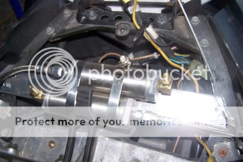

I put the reservoirs up front in the location of the toolbox so I could connect the air lines to the shocks.
The one thing I didn't like about doing it this way was I had to drill a 1/2 inch hole in the side of the plastic to run the air lines to the reservoirs.
This is what the final install looks like.

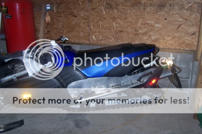

Now its off to put the Apex seat and tank cover on I got from UP Brett
Of course you need to unplug all the wiring to remove the handle bars.
While I was at it I took a picture of the location of my YamaHeater from Rock at the bottom of the staring gate.
I didn't take a pic of checking the exhaust donuts but now its ready for the seat.
I like the looks of the seat on the sled.

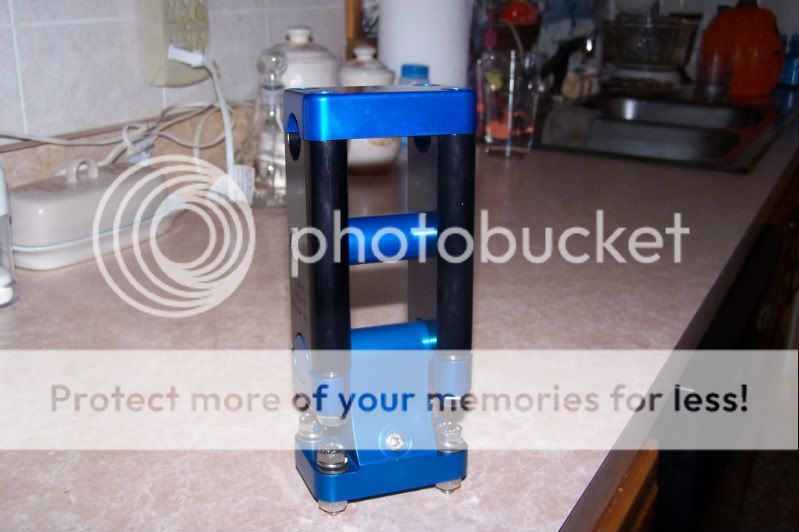

Look what the mailman brought me today.
My Riser I got from Lake Effect Snow Co. A.K.A Superman.
Its a 2 1/2" Pivot and 4 1/2" Riser
He is serious on customer service
Love having my name ingraved in the top cap
Better view
Thanks superman I will do more business with you anytime.
