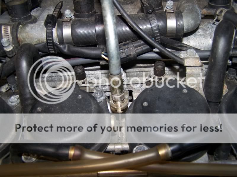

Well I got to work on the sled again today.
Started off by getting a bottle of brake fluid.
Got to the garage and looked at the cap on it takes DOT4
Well its off to put the Apex bars on had to drag the sled out of the corner again.
First thing I needed to do was remove the rivet on the bottom of the bars
Bars on the sled.
I first changed the Parking Brake you can see the new cable is about 2-3 inches longer.
I removed the spring on the brake to make it easier to install.
Then the Brake Line.
Again the line is about 2-3-inches longer
I had to disconnect part of the reverse linkage to remove the brake caliper.
The Choke Cable was next.
Starting to come together now.
Now Throttle Cable time I didn't get a pic but I used a punch to hold the carb open to aid in the change of the throttle cable.
With all Cable changed its now time to put it back together.
I put the bar pad back on for now to hide all the connectors I'm going to extend the wires.
IT LIVES!!!!!!!!!!!!
Let me know what you think.
More to come not completely done but 90% there.
