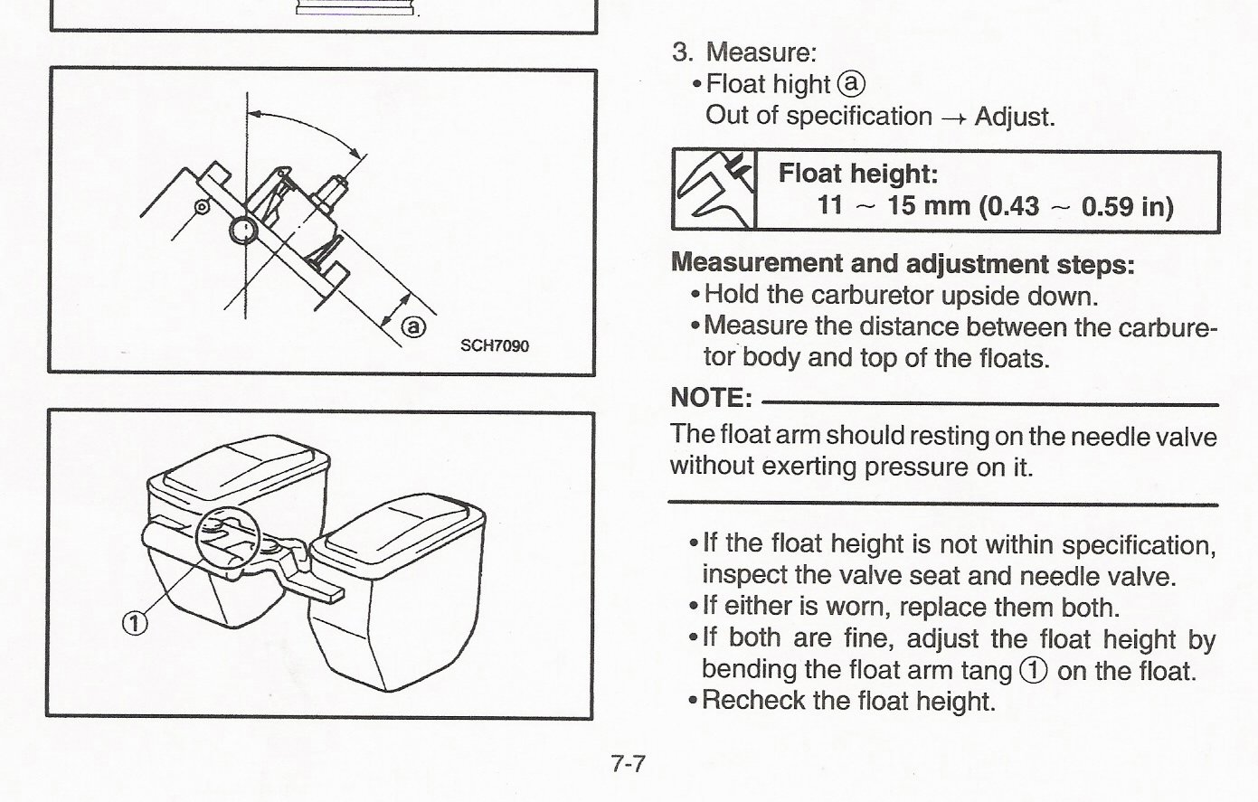

I tend to set mine lower (use the higher mm number) as it seems to run better.
Here is a page from the Service Manual: Float level setting
