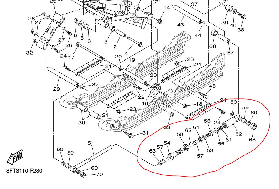

question my rear suspension has about 3 in free play it seems. it does not return to the full up position . what shock would cause this? im curious if i need the lower one rebuilt? does it apply pressure or just a dampener?

so ive had a few other makes where you pull up and it stays generally. this ones falls down three inches even if i pull it up. that normal for the apex? and what does that lower shock do? is it pressurized ? i see its rebuildable from the suspension diagram also. i have an 06 attak gt w 1600 miles but was neglected some

im going to be pulling suspension and taking apart and cleaning and putting in right grease also. last guy used automotive grease. any way i can check that bottom shock?
Are you referring to the transfer adjustment rod when you inquired about the bottom shock? If so, it is not your typical 'shock' and is used to transfer the weight of the sled.
Good catch!View attachment 149536

yes lol looked like a shock to me. i see its rebuildable. does this affect sag? or is this adjustable to bring up suspension?

this is adjustable to help keep the skis down for handling.
