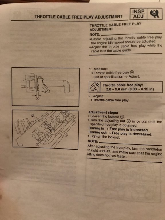

Since this is an ongoing thing, i would check all of these.
Don't forget to check those settings in the dash.
RobX-1
- 2,299
- Coldwater, OH
Thanks Steve for posting those pages as I now see where this process is documented in the service manual I have. The one I have has sections for different models and it wasn't until the last section for RX10RTL/RL/RTRL/GTL/ML, RXW10L that documented the sync process using the air bypass screws; the preceding sections documented the sync process as using the screws in between the carbs.
Am still curious where 74Nitro obtained his pages from as I don't see anything like that in the service manual I have.
