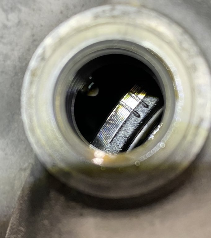

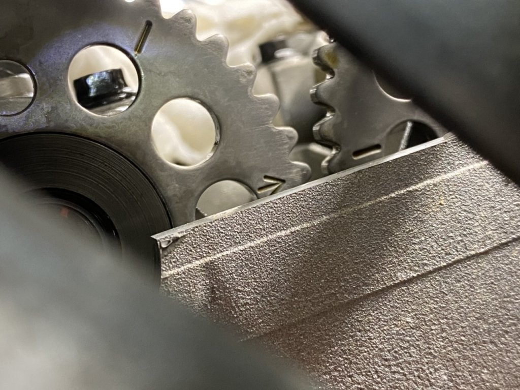

I have never done this job but it looks correct to me ... Maybe ask Grizztracks to take a look and confirm your pictures . Never hurts to get a second opinion.If I set the timing marks on cams level to the head, or as close to it as I could,
My marks looked like this.
But I can honestly say I’m exactly where it was before I did anything. Does it look like it skipped a tooth? Could it have been set this way from factory? I doubt anything has been done to this engine with only 1000 miles on it. I haven’t rode it since I bought it other than on and off the trailer twice. What do you think? Run it? Try to adjust it again? I hope I don’t have to do this again.

No worries,, the timing marks are spot on. It's not off at all.

Thanks, I really appreciate you chiming in.No worries,, the timing marks are spot on. It's not off at all.
