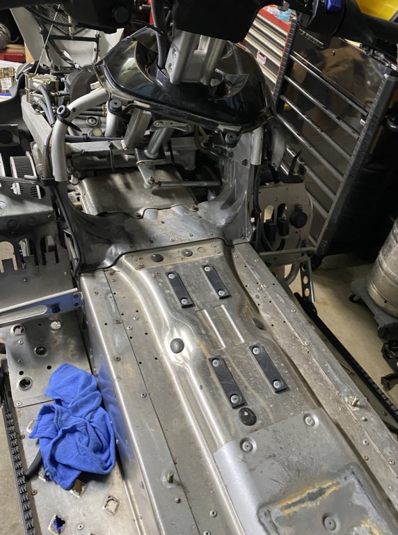

I did find a small nest down low in the nose and also a couple wires that appear to have been chewed on. I think it might be ok to just put some liquid tape on these wires and call it good. I’ll try to pull the pins and slide a piece of shrink tube on them but it’s gonna be easier to just coat them. What do you think?

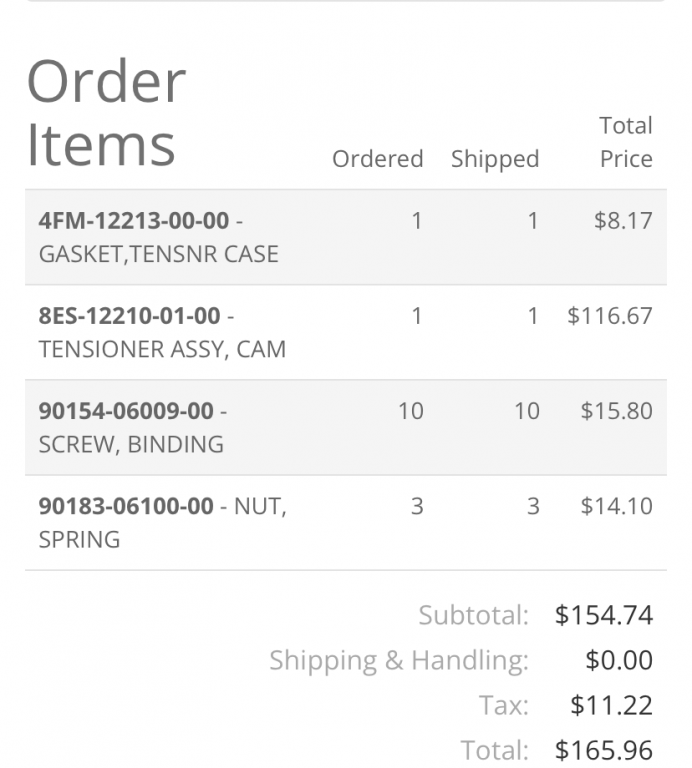

What did Yamaha charge you for the cam tensioner?

I think I got the tensioner for $116. I’ll look it up. I got it from Partszilla but it was a wait because they aren’t in stock anywhere.What did Yamaha charge you for the cam tensioner?

Part numbers and everything ! Good job

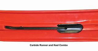

Have you done anything with the Ski's ? When I first got my sleds I shimmed the ski rubbers and ran 6" carbides with the Half pipe mod on the first carbide bolt. This ran awesome for the first 2 years then I went with Bergstrom Triple points on stock ski's and a little less thick Shim. Now I run nothing but Snowtrackers . They really do make a difference.Snowbound98

I haven’t done anything with the skis yet. That seems like a great idea! Looks like a schedule 40 pipe? That’s ingenious. The carbides on there now seem to be wearing even. It might already have a shim, I’m not sure. I’ll probably get something different on there. Doubt I’ll do anything right now, I need to have this done by Tuesday so I can load it on trailer and head north.Part numbers and everything ! Good jobHave you done anything with the Ski's ? When I first got my sleds I shimmed the ski rubbers and ran 6" carbides with the Half pipe mod on the first carbide bolt. This ran awesome for the first 2 years then I went with Bergstrom Triple points on stock ski's and a little less thick Shim. Now I run nothing but Snowtrackers . They really do make a difference.
View attachment 165245 I made a bunch of these blades out of SS 1.25" Dia. Pipe worked awesome. If you google SLT Keel Blades, you will get better pictures

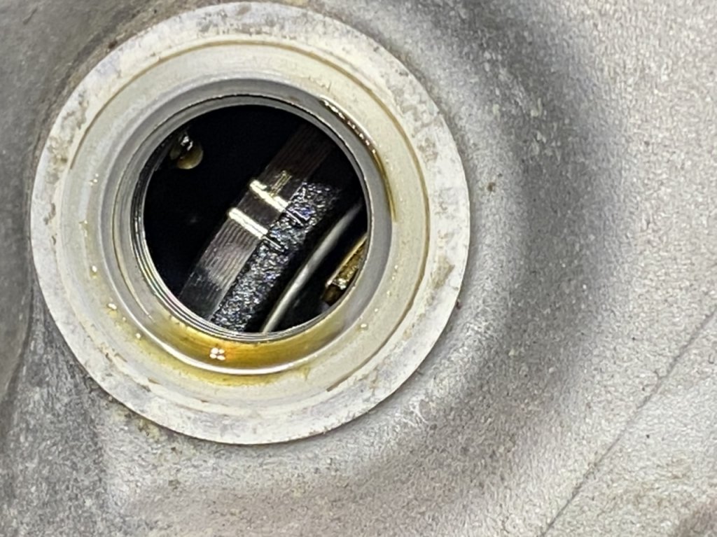

I didn’t get back out to the garage until later this afternoon. First thing I did was rotate the engine 5 full revolutions and make sure my timing was good.
Before I did the tensioner this is where I was at.
After the tensioner I would say I was in the same place.

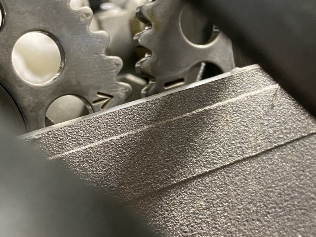

If I set the timing marks on cams level to the head, or as close to it as I could,
My marks looked like this.
But I can honestly say I’m exactly where it was before I did anything. Does it look like it skipped a tooth? Could it have been set this way from factory? I doubt anything has been done to this engine with only 1000 miles on it. I haven’t rode it since I bought it other than on and off the trailer twice. What do you think? Run it? Try to adjust it again? I hope I don’t have to do this again.
