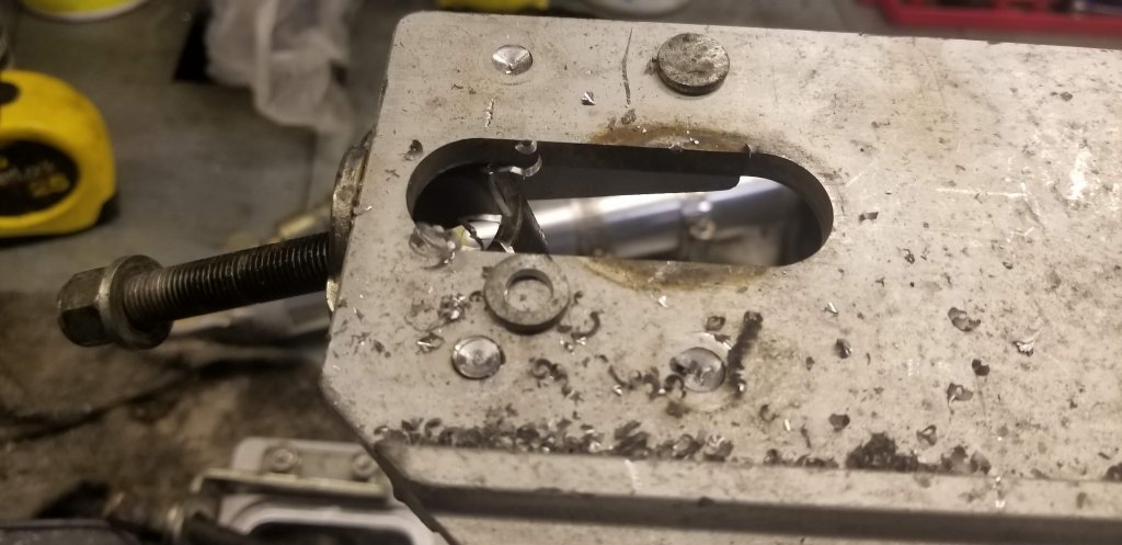

working on the Phazer just waiting for track drivers to come in. I have repaired the skid and installed the rail extenders. I rebuilt the rear shock and changed the shim stack a bit. Also have installed torsion spring spacers and changed all bearings I could. I re greased a few of the idlers and replaced the two outside rear idlers. also have another marginal snow wheel kit I will be installing. I have also change the exhaust doughnuts to the kit from fx garage, cleaned out the oil passage for reverse drive, painted the seat frame, replacing the drivers, repaired wiring to rev sensors, rerouted brake light wiring, replaced shock link, repaired holes for link, replaced fts shock bottom bushing. Also getting the seat redone to be higher and a bit wider. (about 1/3 the cost of buying a seat on line)

put the track and skid in on the weekend.
Looks good.
