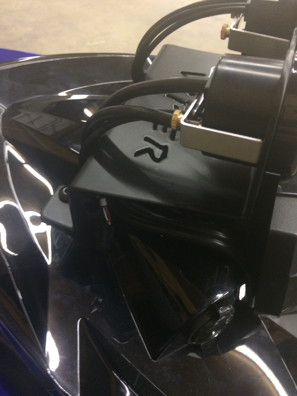

Here's my setup. I just tapped into the 12v plug on the dash.

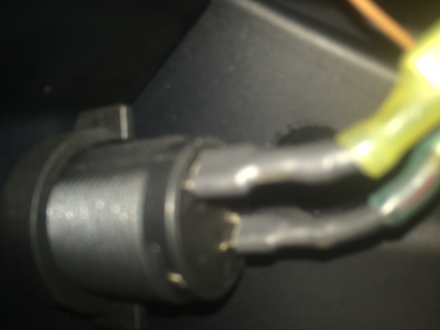

Here's my setup. I just tapped into the 12v plug on the dash.![]()
When you tapped into the cig lighter did you solder the wires and or use heat shrink? Seems like a nice set up I might have to copy yours.

Just crimp and seal connectors. I really like it because when u take your hood off you don't have to unplug anything.When you tapped into the cig lighter did you solder the wires and or use heat shrink? Seems like a nice set up I might have to copy yours.
