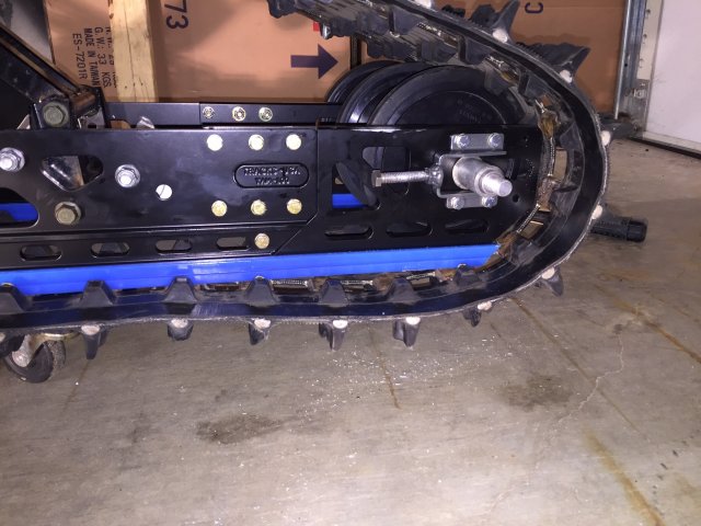

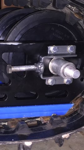

I ended up elongating the axle slot and modifying the original track tensioner to bolt onto the outside of the rail.
Oh that looks good. Any details you can share on how you modified the track adjuster to outside of the rails?
Thanks, G.B.
Thanks, G.B.
Basically, I flipped the bracket around to face the front.
There is a circular tab that wraps around and rests on the back of the rail to provide support when the adjusting but is tightend. When I flipped the bracket around, the tab hit the rail...so I cut it off. Then I tacked a 3/8" nut onto the face of the tab (where the original nut would tighten against). Had to make sure the bolt angle was parallel to the rail. Drilled two more holes (I used the original front hole in the rail for the back bracket holes when the bracket was facing front). Welded the nut up....some primer and gun metal spray bomb I had lying around and Bob's your uncle.
I happened to have a couple 3/8" stainless bolts and jam nut along with some anti-seize.
Cool, thanks. I might have to switch my adjusters around like this. It is easy enough to do with my Tracks USA 144" extensions now that the solid rivets for the track adjusters are replaced with bolts. Thanks, G.B.

If you don't have access to a welder, I would just get some aftermarket adjusters that bolt in. I found some on eBay....I just didn't want to wait for them.
