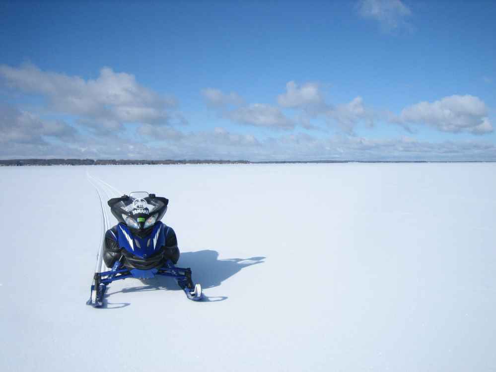

I am not a laid back rider. I am not a UP or Canada flat long trail rider. The majority of my miles take place in lower Michigan on the weekends. This involves hundreds of miles on a bumpy Saturday evening. I ride as hard as I do on flat trails as I do on heavily moguled trails. This obviously is going to take its toll on any machine. Sure, you can put 30,000 + miles (hondo) on a machine in near perfect conditions and experience very little problems on a Yamaha four stroke. That is not where I live and not how I ride so the outcome will be different. I put so much time and money into maintaining my toys by keeping them clean and staying on top of all maintenance. I do not abuse or neglect the things I own. I ride them a lot and ride them hard.
I started doing the majority of my own work this year and this has helped me experience very little downtime compared to last year. I think I may have missed 1-2 weekends this year with a little over 7,000 miles so far. This site is a huge help! So I can't thank you all enough.
The ZX2 is without a doubt the way to go for any rough trail Apex rider. It is far superior then the monoshock in durability when it comes to riding hard.
The sled still gets a lot of attention and I get asked questions frequently about it. Then when mileage comes up from a other brand sledder, you should see their faces. Most can't comprehend a 20,000 mile sled!
I have demanded a lot from this sled. After 4 years of riding I have been the happiest with the sled this year as I have worked out as many bugs that I could. It is one of the if not the best sounding sleds out there in my opinion. The motor is a beast! I love it.
I am not sure what the life of this Apex holds. I am debating selling or keeping it forever since it is worth way more to me then I could get for it. I have always regretted selling any sled of mine in the past so we shall see.
I am crazy about snowmobiling and it is a HUGE part of my life! With the Apex I enjoy the sport even more! Happy trails!
