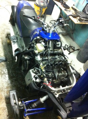

Ok ! So I removed the secondary clutch and the speedo thing to access the bearings. they were very dirty with old grease. Drenched all that with wd-40 and cleaned with my compressor a couple times. I think they're good to go at least for a couple season ? (see pics) Will refill all that with fresh grease using the needle.
BUT... Trying to remove the primary cluctch. I wasnt able to pull it out, did some research and realized I need a clutch puller to do that .. So do I need to get one ? Is it a good idea (worth it?) to remove the clutch to clean and grease the bearing ? (will it be accessible?)
Thanks here is some pictures !

There are no bearings behind the primary clutch. It is Easyer to clean while disassembled when off but not nessasary. No lube in clutches at all btw if you are not aware.

I've read about people removing the primary clutch without a puller by using the bolt that holds it on. They use water or grease and put it inside the clutch the bolt goes and then instal the bolt back in the clutch. When you tighten the bolt it'll build hydraulic pressure and pop the clutch off. If you use water you will probably need some teflon tape on the threads of the bolt so it doesn't leak. I've never tried this method, but I've read about quite a few people doing it this way. If you decide to get a puller I would recommend getting a Yamaha puller. Some aftermarket pullers don't last very long at all.
