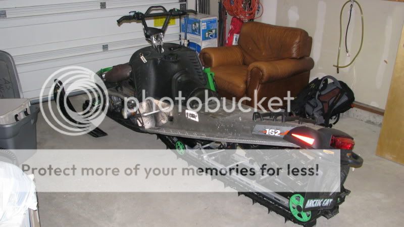

Ok, so its not blue but its still a a summer build technically. Project: backup sled.
Nikolai
Your garage is way too clean.
Nikolai said:Your garage is way too clean.
No Joke, do you realy need a chair like that for working on a sled?
Do you have a seat for it drew? I have one off a 07 if not.
Oh and if you want that "mod" hood i'll be running to Valdez this weekend I can pick it up
HYFLYR
I do need a seat, and ill let you know on the hood. I pretty much need alot of things, well everything plastic and, well, the list is long!!!
This is just one of many projects for me this summer. Next will be a 2010 tunnel to be powder coated, possibly a mcx turbo build, some timbersled parts to be put on and a few tricks up my sleave on my own sled, but all in due time.

What happened to the putty tat???
HYFLYR
Bought it from a guy who sailed it off a cornice, supposedly a 100ft drop. It looks pretty bad so im not doubting it but a little spitshine and elbow grease and it will all buff out........ i hope.
