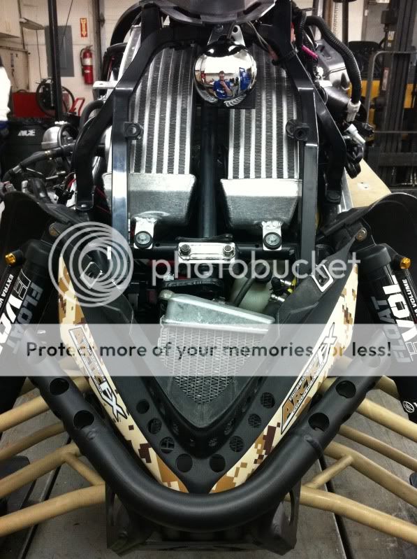

Well this nypex is taking forever to say the least. Seems like im fabbing up something or waiting on another thing. Heres a couple pics for the curious.

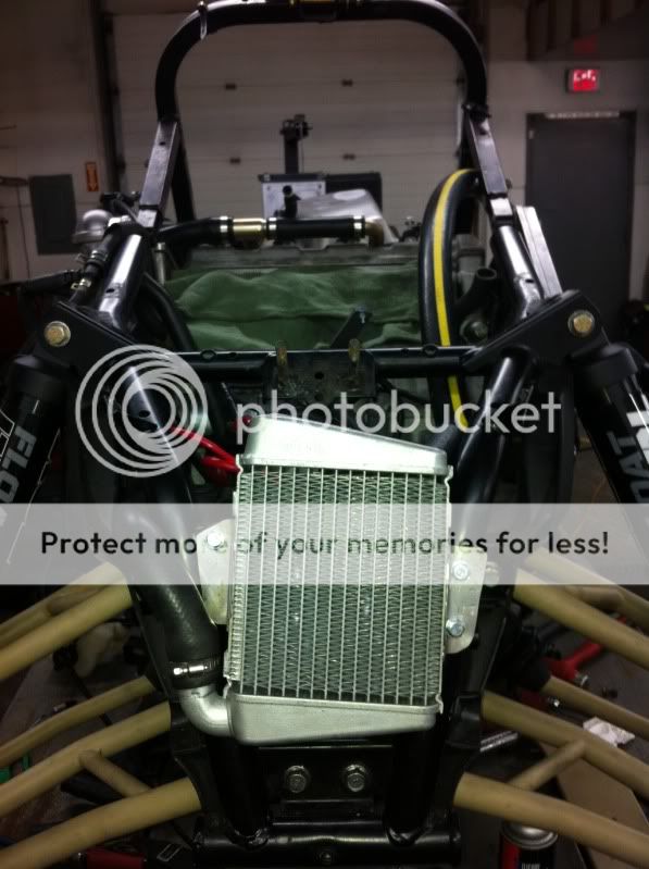

It not only has under board coolers but also a nose radiator, not something you see everyday.

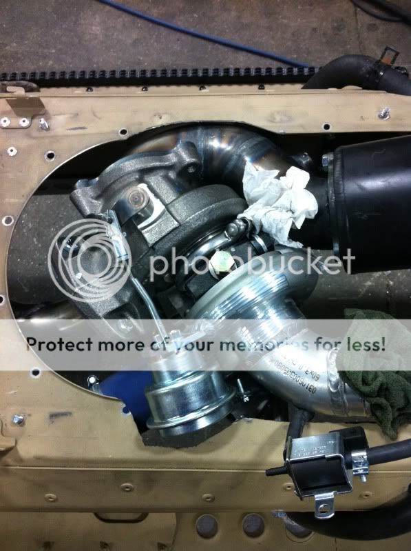

Turbo fits a little different for the apex setup so some trimming had to be done.

I thought about the nose cooler using motocross coolers, but they use 3/4" hose, not 1" like on nytro and never went much further. Where is the cooler from? I am assuming it didn't come with the Nypex kit.
It would help lowering the CG,and there is alot of space down there...kinda..

It's actually out of the apex, it's the lower right hand cooler above the footwell. And your right, there is actually a lot of room for hoses and rad, although it has to be mounted a little crooked to fit correctly bu that's alright.

Looking good. I have a couple new 1" plastic 90's I bought from Home Depot if you need any for the cooling. I didn't end up using them on mine.
