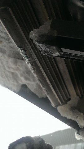

ok "back to the drawing board" I converted a vector to a 144 skid. As you can see my studs ate into the rear heat exchanger. You will also be able to see that we used a hixfax/slider bolted underneath( this works fine with my apex 144) Anyhow what would be the best way to fix? If I move it back a few inches I will need a new set of brackets and most likely longer heat exchanger. For all the work this set up is amazing really happy with it.
The long track sleds had a different cooler that does not stick down and cause interference.
We build a cooler that fits the long track sleds and comes with tunnel protectors already installed. Also twice the capacity of your stock rear cooler.
