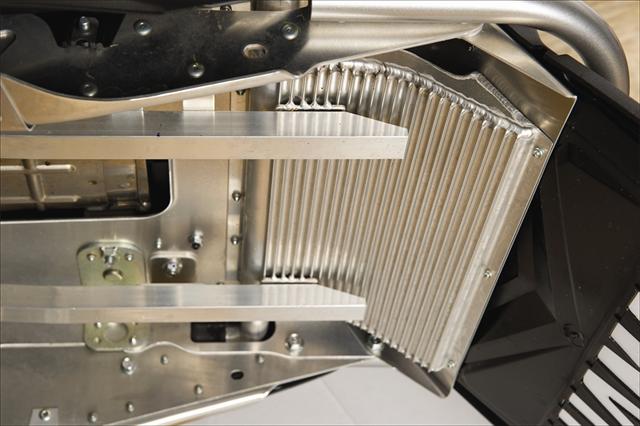

Just wondering if anyone could post some pics of the rear of a 2011 Apex tunnel. Looking for some close-ups of the snowflap-bumper area. I have an 06 APex extended to 128 and want to extend my tunnel for clearance. Just curious what Yamaha did to the 2011's to make them fit. Thanks.
There is a few pics on the yamaha web site.You can zoom in also.
http://www.yamaha-motor.com/sport/produ ... lery.aspx#

Perfect. Thanks. Man, it would be nice to incorporate a cooler that size on my 06.

jaydaniels said:Perfect. Thanks. Man, it would be nice to incorporate a cooler that size on my 06.
That would be sweet and would keep our older models a ton cooler in lower snow conditions!!!!
It kind of looks similar to a srx heat exchanger.

I wish I could fine one that size just flat.
APEX 06 said:I wish I could fine one that size just flat.
Huh, I thought it looked like my attak cooler in size, only the attak cooler IS FLAT. Do you guys really think it is bigger than the attak cooler????

The SRX cooler is closer to a right (90 degree) angle from the tunnel to the "bumper" flange. The one in the picture appears to be closer to 120 degrees. Could be an optical illusion though...

Are the rear and running board exchangers just a hollow cavity in the middle or are there fins? Thought of building some rear coolers.

Well, decided to build my own tunnel extension. I'll post pictures when I get a chance. Just wondering if anyone with an 11 or newer Apex could measure the rear heat exchanger. I may try to incorporate one into my 06. Just need to know the width, lenght and how deep it is or the distance from top of tunnel to base of the exchanger at the very back.

Ok, just measured it,
Width- 13 1/4 "
Length- 8 1/4 "
top of tunnel to the base at the very back- 4 3/8 "
Hope this helps you out
