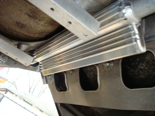

Nick1945 said:You could get one like this from Yamaha, or Pioneer Performance. They are about $ 150.00.
This is on my '06 RS Nytro, its out of harms way, and my track is studded, and I never had a problem.
The size of this one looks perfect but the only issue is that it doesn't seem to mount flat against the underneath of the tunnel but rather hangs down. If I leave it in the stock location the track will still hit. Any way this could be mounted flush on the underneath or anyone know of a cooler this size that mounts flush? Any of the older 2 strokes or anything have one?

Here's a thought. You could buy the small cooler picture above and if you know a good welder just cut the elbows off and rotate them so the cooler could lay flat like you want.
kinger
- Jan 17, 2005
- 7,418
- 1,556
- 1,963
- Clear Lake, IA
- www.piergenius.com
You dont even need a welder just cut them off then rotate the unit and use a short piece of tube to connect the rad to the elbow, exactly how Ulmer and others do with the larger unit when they get it to tuck up in there nicer then stock.
Only issue is you will have to cut off the brackets in the back side that its riveted to the sled now and you wont be able to support it with anything other then the rubber hoses on each side. Which is fine.

Okay, great idea. That's what I'm going to do. This way I can use the stock holes in the tunnel for a cleaner look. Thanks again for the tips.
