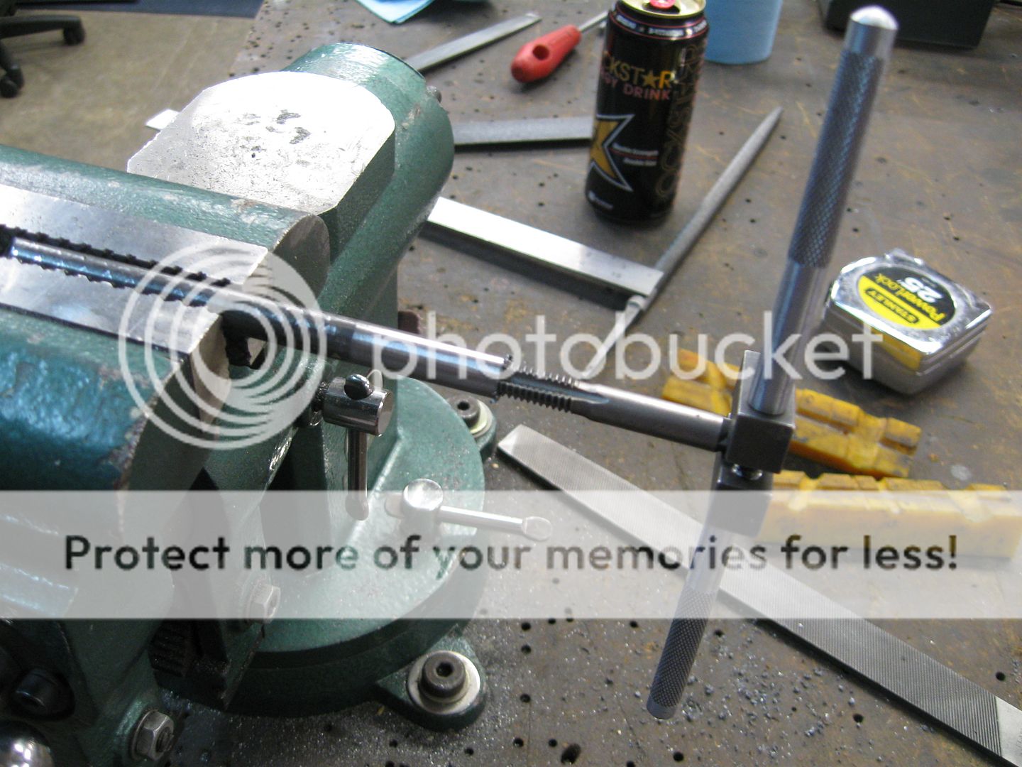

Started by tapping some 3/8 .058 chromoly
1/2x1/2 .035 mount
Threaded sleeves welded
Had to notch the 1/2" cross tube
Finished
Working on the front seat brace and battery bracket next.

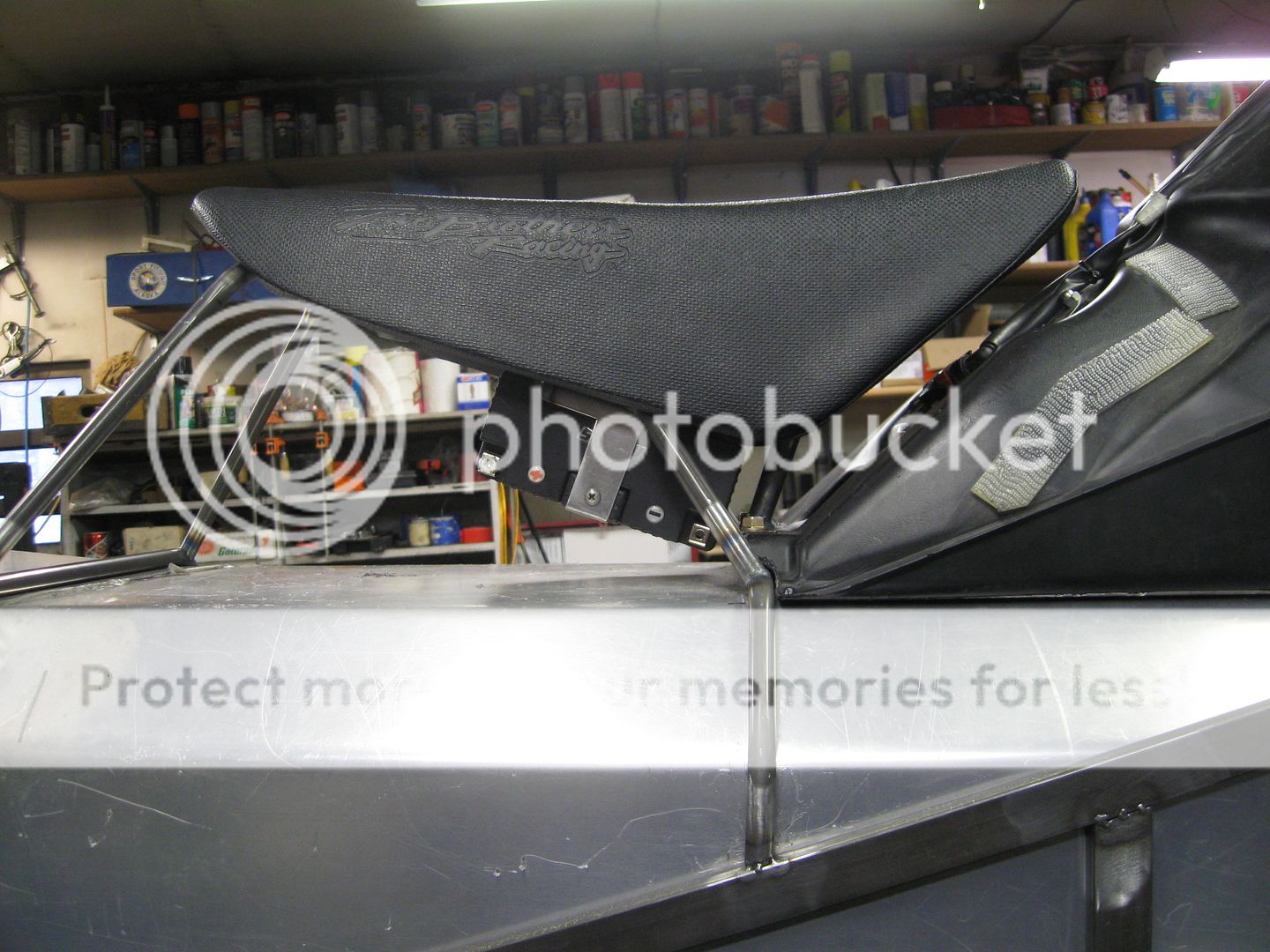

Nikolai
Got part of the front seat support done.

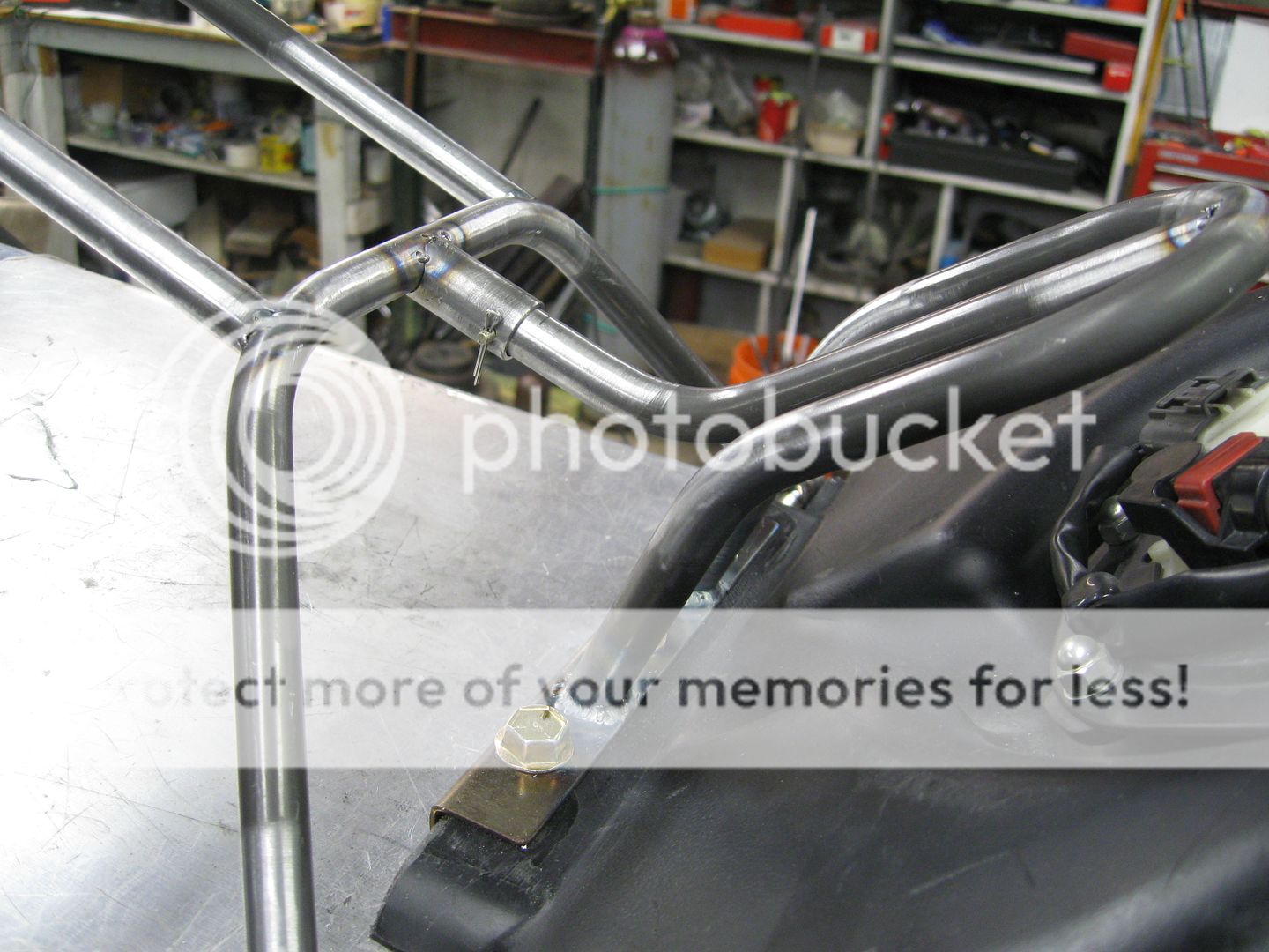

Nikolai
Front seat support brace done. Just have to add a tab to keep the front of the seat locked in place.

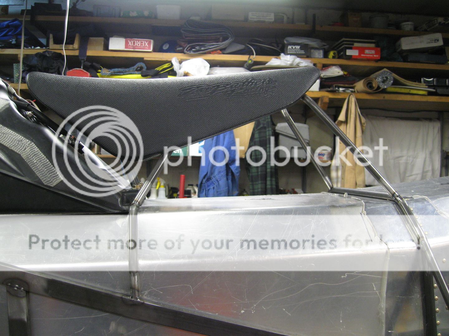

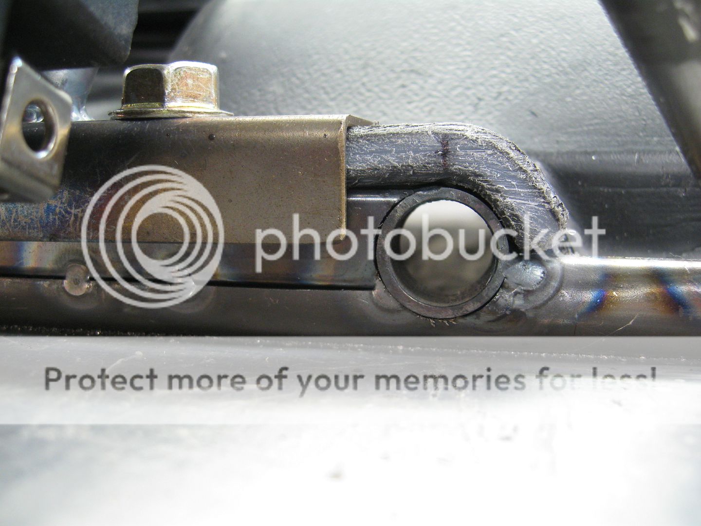

Nikolai
Finished welding the seat support.
Added a 5/8" .058 sleeve for the battery cables to pass through.
I had to prop the chassis up so I could weld the bottoms of three seat joints before installing the battery tray. Wednesday I'll be getting the super short back cap for my torch, it was a royal PIA fitting the torch inside the seat frame and the welds show it.
Battery tray in place. Once fully welded, the tray ties all the front tubes together to act as a giant gusset.
More tomorrow.

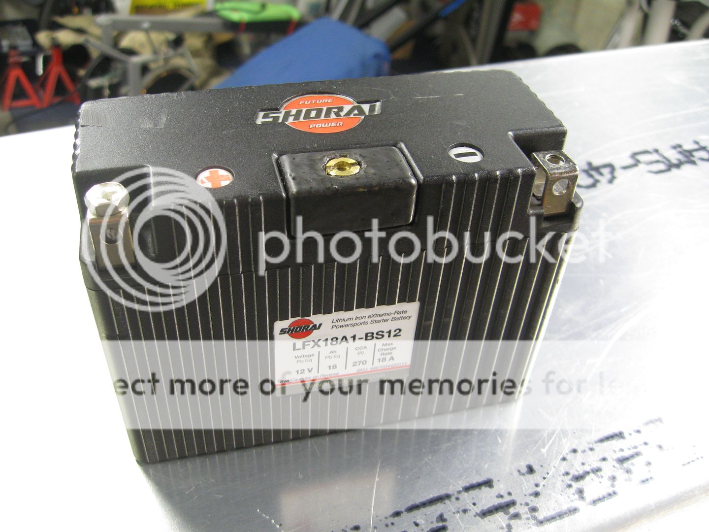

Duey782
Just be sure that your battery is made to run off of vertical, ok? Some are vented and some are sealed.
Nikolai
Shorai batteries can be mounted in any position.
Nikolai
To secure the battery I made a small oak block, set a brass threaded bushing in epoxy, then coated the outside with a couple layers of epoxy. A small 10-32 screw holds the battery place. It weighs almost nothing and is very secure.
