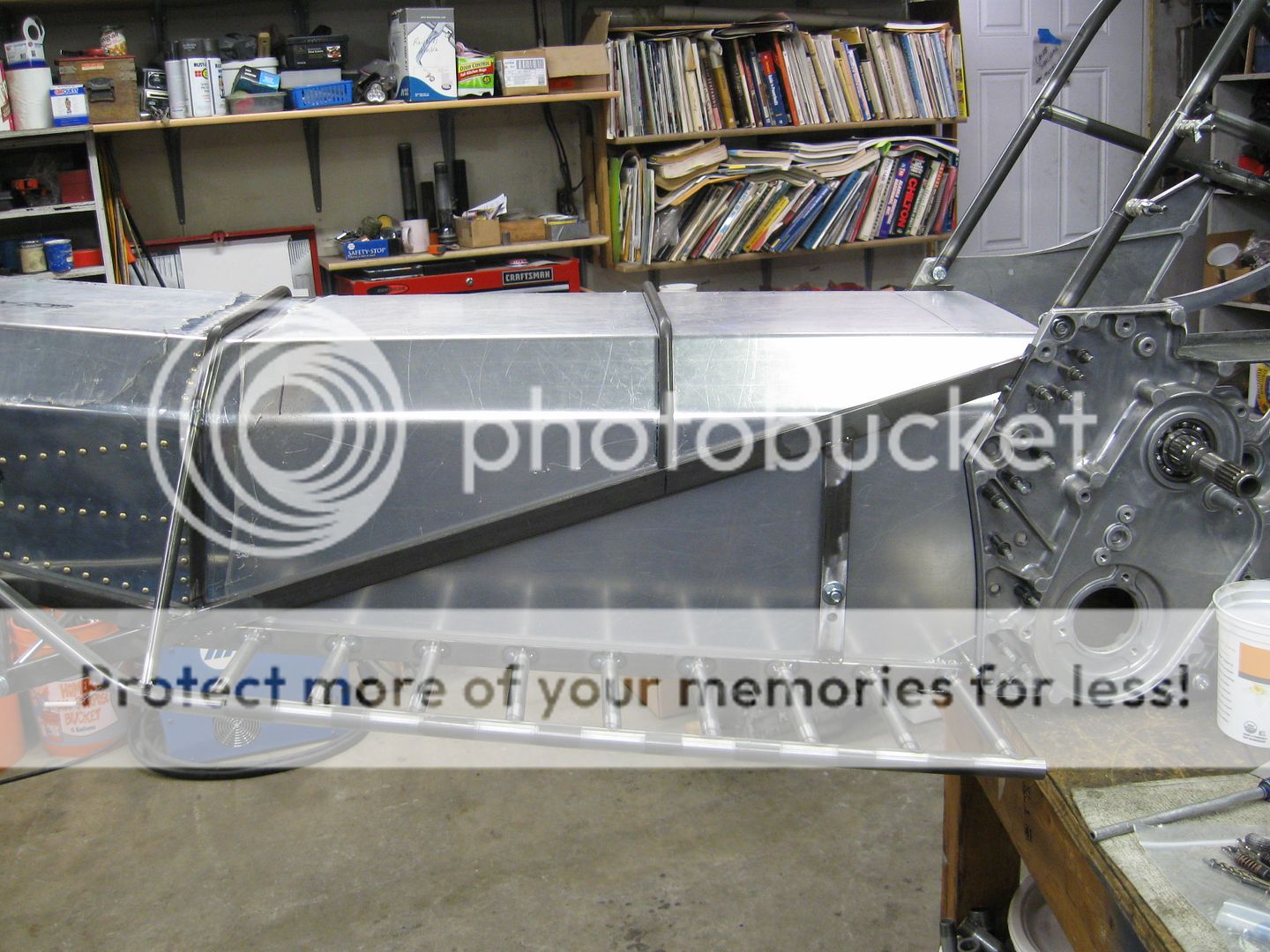

I'll be on it again Saturday. I'm still working out of town 5-6 days a week. I spent last Sunday tearing my sled apart so I could rob the coolers.
Nikolai
Picked up my 156x16x2.5, 153 Ice Age rails and Synapse diverter valve today.
Nikolai
Got the cross bar done for the gas tank/seat frame. Another 21 rivets in that sucker. Sunday I'll get started on the seat frame which will tie the two cross bars together.
Here's a pic with my old seat frame just for a reference. I'm going to try and tuck the battery in their too to get some more weight out of the front.

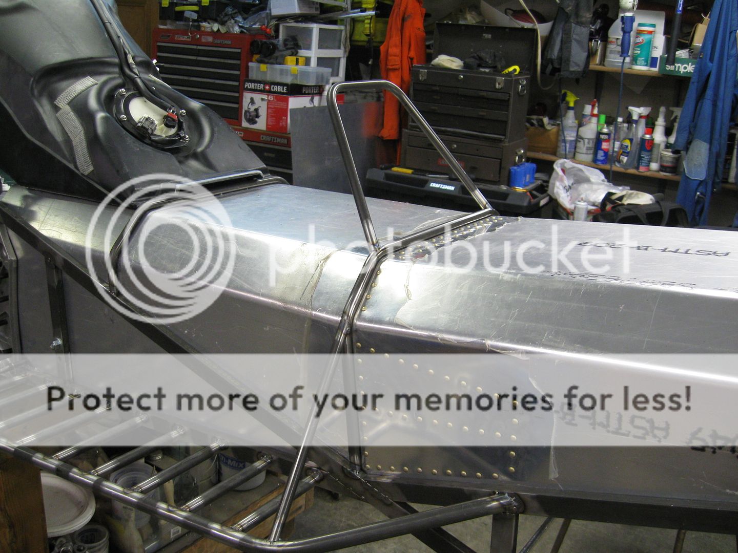

Sportsterdanne
Will the turbo be behind the seat or under it ?
Nikolai
Under it, right behind the battery.

Gas tank trimmed for the cross bar
I'll have a forward support for the seat but it will be bolt on. It's a tight squeeze to get the gas tank out as it is. When I get back next week I'll finish the gas tank mounts, seat mounts, battery bracket, and misc. tunnel items.
My old seat frame was 2 lbs + bolts. Current one is about .75 lbs worth of 1/2" tube.
