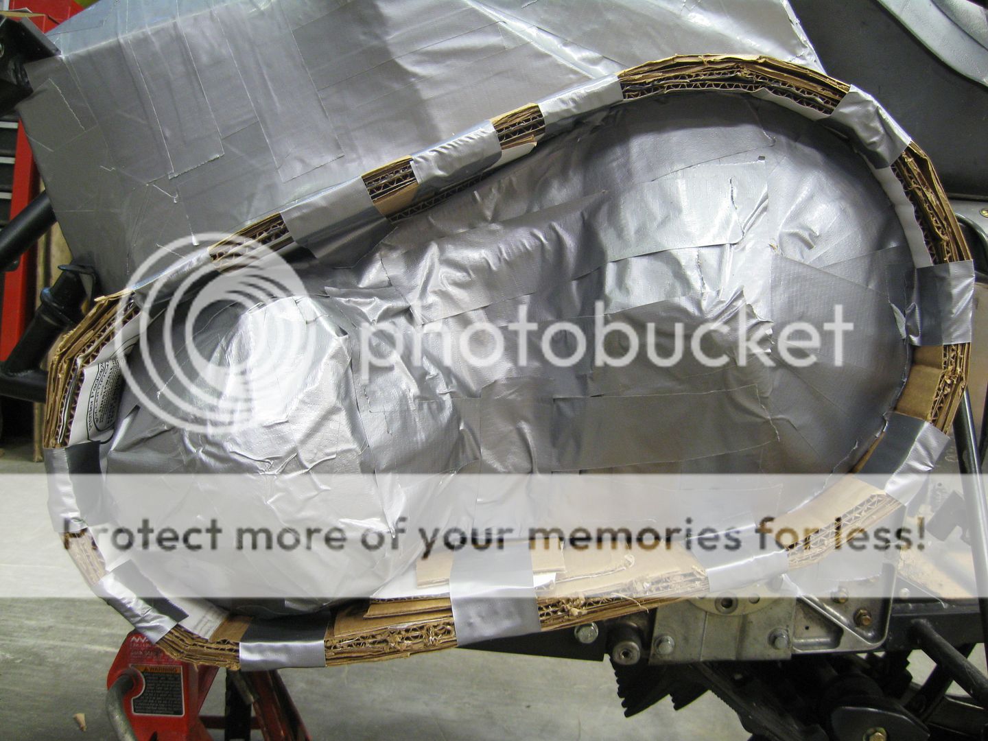

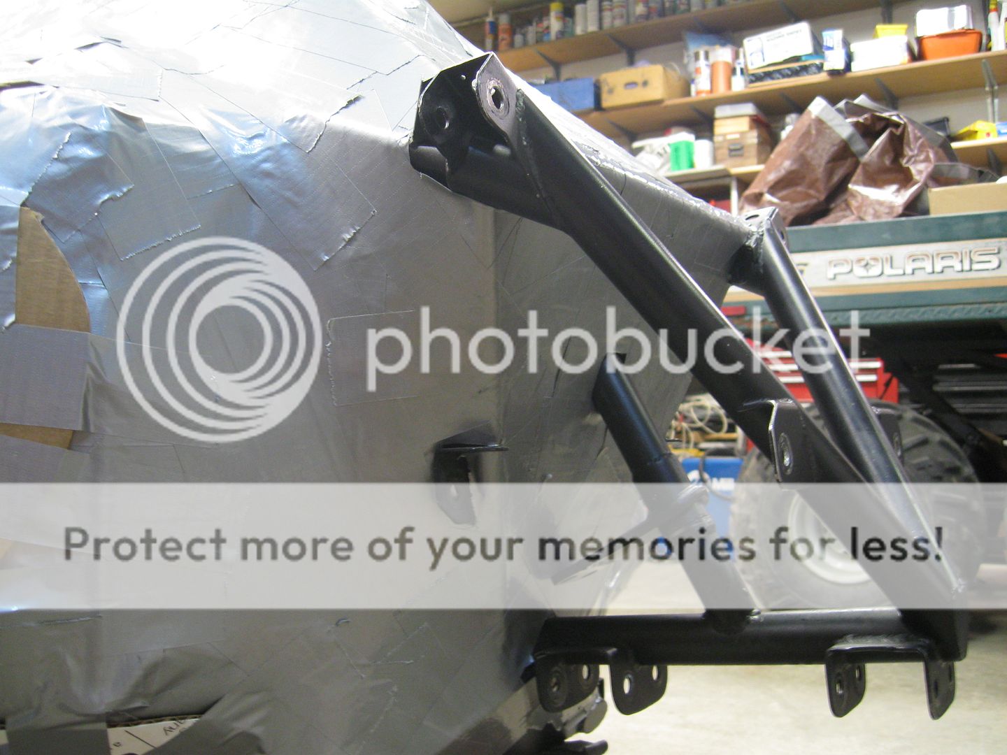

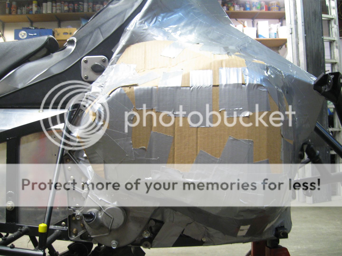

So the duct taping/cardboard work is about 95% done I think.
I wrapped the clutches with four layers of cardboard, should end up with at least an inch of clearance with the finished panels.
Adding the outer piece
Added a little filler to get rid of the sharp inside corner.
Clutch side pretty much done.
Just clears the speedo gear.
Did a little more work to the other side.
And a front shot.
I know it's picture heavy, but I wanted to get opinions on how it looks before I wrap it in fiberglass. I picked up another 16 sq. ft. of fiberglass cloth and polyester resin today. I'll finish the rest of the prep work Friday night and then Saturday I'm hoping to glass it.
And a front shot.

I like where you are going with this, should be quite light, but who about having the top of the clutch side angle up to match the brake side more? Would give you room for a spare belt there and shouldn't affect the weight/snow drag much at all. Just my opinion of course, I can't wait to see this finished and the final weight!
4strokes are better than2
wow you would make red green proud with that duct tape job
i think it would look better with matching panels too,but if weight is the ultimate goal looks dont matter.
I would make it symmetrical and kind of "aerodynamical", like mesh hoods. I think it would be even lighter if you make it without all bends and corners, also snow wouldnt build up so easily everywhere and that is all away from driving weight. Maybe try it? Just bend blanket or something over the front end and tighten it. If you want it to stay in shape, just wet it with resin and let it dry. You can laminate over that when it is hardened or just put some urethane there where you want to shape it more. Then just put tape over urethane and you can laminate over that. I can see that your sled could get just two piece hood or three with two small underside panels and one big overhood. When you make it from carbon, I think it should be around 4-5lbs, maybe even lighter. Srx kevlar hood weighted around 6lbs, so it would be much lighter from carbon.

Well, I decided to keep it as pictured and glassed over it Saturday. Did two layers of cloth and three in a few places. I'm going to start shaping with the Bondo today. I'm having some computer problems so I won't be able to post pics until Monday after work. It looks good glassed though.
