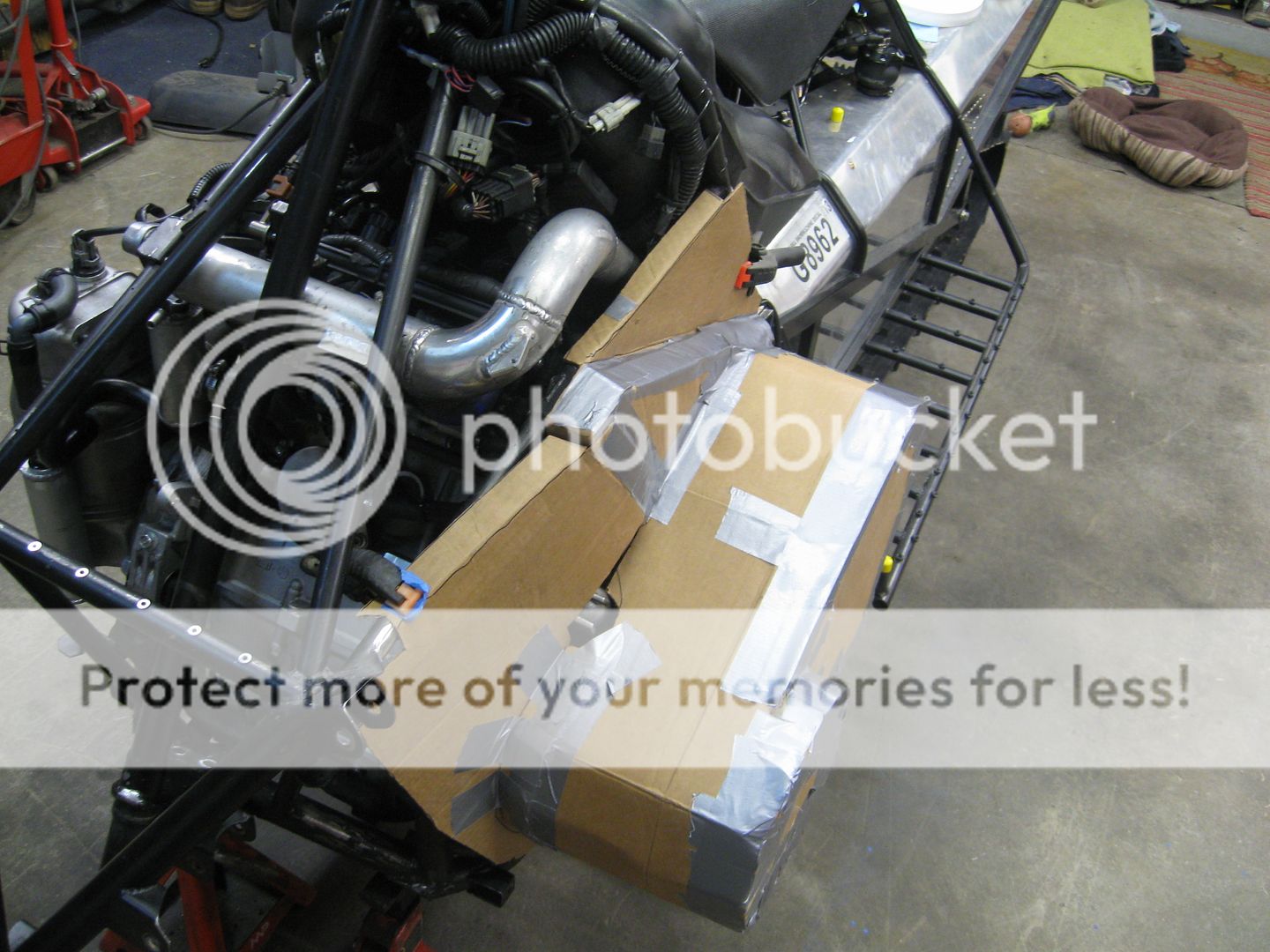

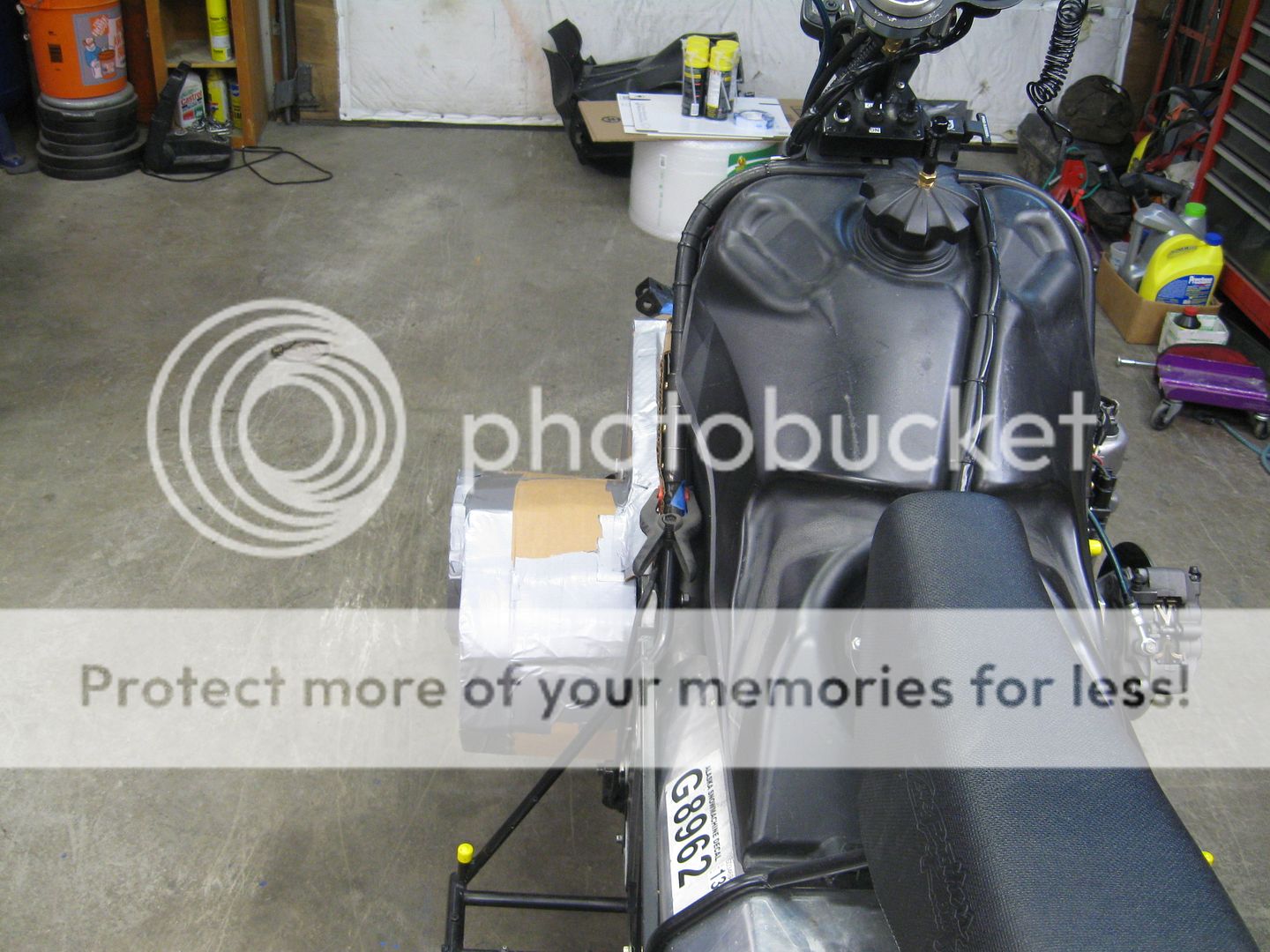

Nikolai
Got most of one side mocked up with cardboard. I'm just trying to get an idea of what I want before I go to town with the foam.
As of now I think I'm just going to leave the sidepanel exposed as pictured.
Few more pics. The edges of the clutch guard where it covers the primary will eventually have a very large radius so it can't catch on anything.

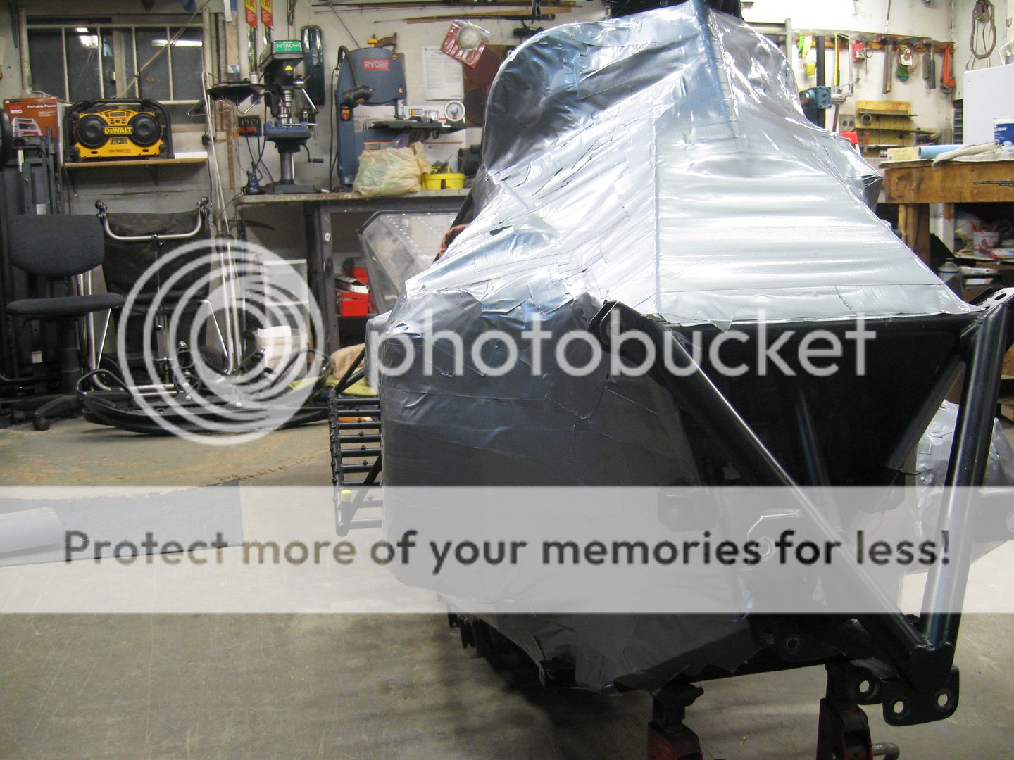

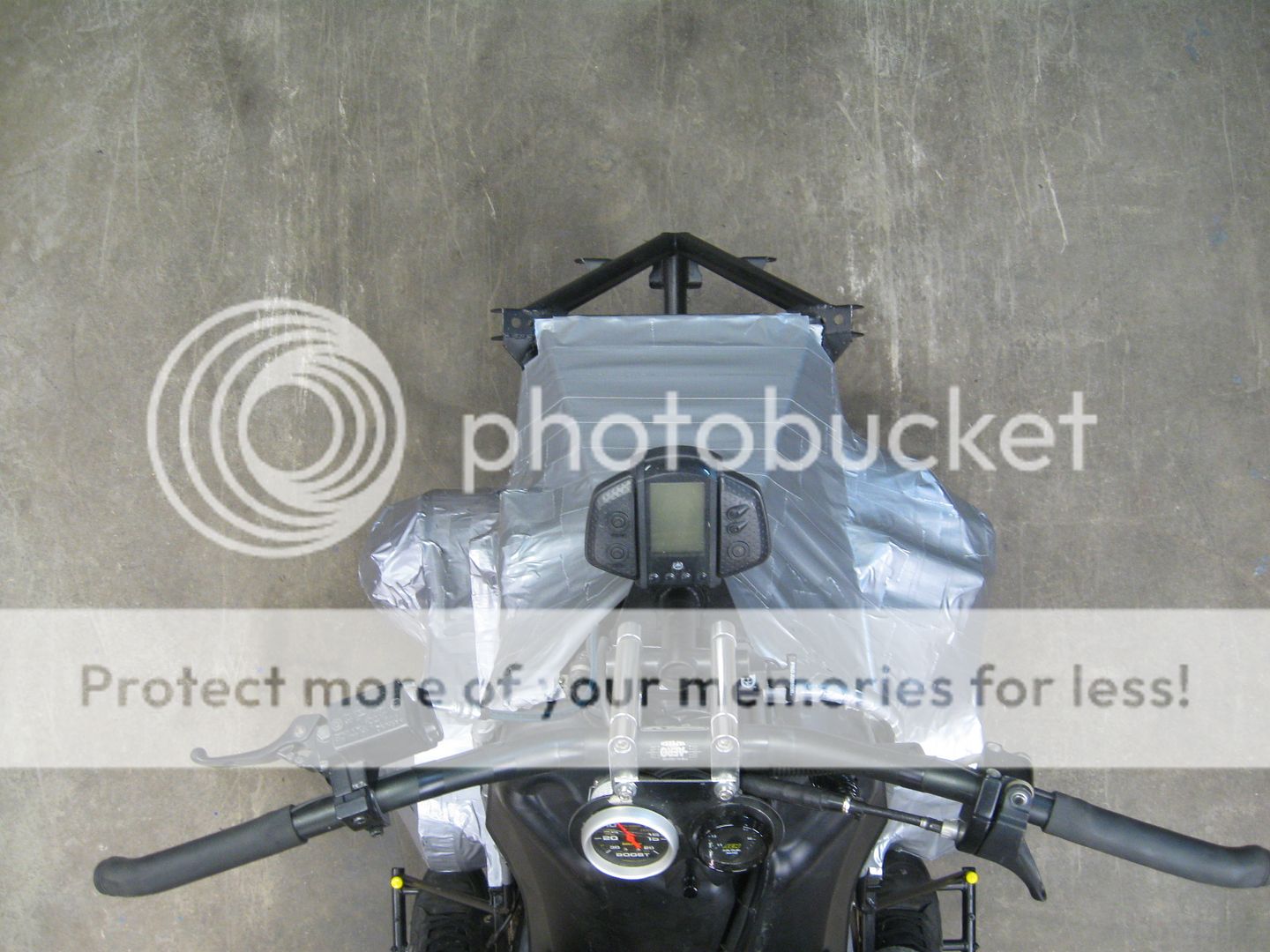

Nikolai
It will be attached with as few fasteners as possible. I'm hoping no more than 10 for all four pieces. I will add kevlar to the clutch area for added protection.
I finished the majority of the duct taping tonight. Right now, it's about as compact as you can possibly get a nytro. I will have to increase the area around the clutches, and brake rotor slightly for air movement. I bought a gallon of Bondo today and some fiberglass cloth. Once I get the duct taping 100% done I'll wrap everything in a couple layers of fiberglass and then start the final shaping with Bondo.
For now, I'm not going to come all the way down the chaincase, only to beneath the rotor. Still kind of undecided.
Pretty slim from the riders POV.
And here's a few pics of what I like the most and have been wanting to do for a couple years now, increased room to get the boots forward.
Don't be afraid to tell me it's ugly or hideous if that's what you think. You won't hurt my feelings haha.
