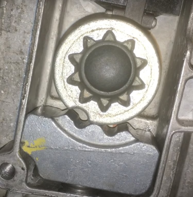

As the title states, lost reverse on my viper today.
Did chain case and oil change last week. Been on a few rides since and the reverse has worked just fine. Went to back into the garage today after my ride and reverse button does nothing when pressed.
Checked all wire connections, fuse, relays, and they all check out.
Any one have some direction of what to try?

if you remove the actuator does it actually work? Wire it directly to a battery to rule out the switch. Work from there.

test actuator as they are a known failure item. lots of info in this forumn on fixes/diagnostics.

The headlight does dim when the reverse button is pressed. Going to remove the actuator to see if something is stuck

The bottom of the actuator has a black pin on the one side that has been known to pop out also.

I’m thinking this may have been initiated when i reinstalled after the oil change maybe by clocking it too far and forcing the bolts to lineup.

Mine did exactly the same thing. Pry the round cover off the back of it and check for moisture in there. Mine froze the the large gear and then it forces the worm shaft out the bottom because it can't rotate the large gear. Your only recourse is to replace the whole unit. Some people have done temporary fixes but that's all it is.Upon removal of the actuator, the small plastic circle on the bottom has broke and the metal shaft is pushing through. Is this shot?

Did you clock it like this before you put the actuator back on?

Yes. Just like that.Did you clock it like this before you put the actuator back on?

I didn’t. Which probably means there was added stress on the reverse motor that eventually broke through the case after a few shifts
