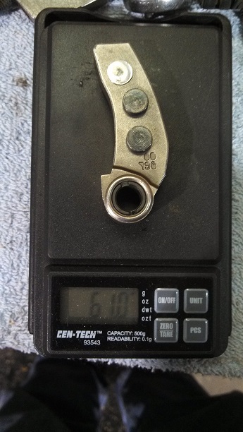

Buster696
Ran the 8dn belt for a 50+ mi ride with the following changes.
Primary: 14.5 rollers // ST’s with 2g’s in heel. When I ran them stock seemed to up shift too much, so I slowed it down a bit with the 2’g per. Stock primary spring.
Secondary: Hauck 47/41 with Silver at 70-deg.
Results: Love the low engagement 3000rpm-ish. Actually pulls harder than stock. RMP is low at 8400~8500 on a standard pull. On a longer pull on trail/hard pack creeping up past 8500 and could feel the MPH gaining. Sled felt quicker and more consistent with 8dn meaning each ride/turn through the trail was always there and ready for some more. Clutches were much, much cooler than the stock belt even when I checked it on a wide open run.
Changes: going with a little stiffer primary spring (total force). First going to add 10kg of total force to get the RPM up to 8800. Then going to play a little with secondary spring(s) as I have a few different stock and non-stock/OEM ones in my tuning box.
Also, here are a couple picks of the weights-stock and ST’s I’m using.
