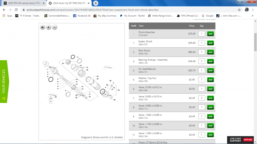

Travis at BOP I am sure has one. I have one also. Revalved though so $150 and shipping a new one from on line is about $90.
And yes the limiters stretch. Last hole can become unusable. But Water/Ice is powerful.

I'll keep it in mind. I find out tomorrow the delivery date for the shock.Travis at BOP I am sure has one. I have one also. Revalved though so $150 and shipping a new one from on line is about $90.
Is yours a 137" if so here
