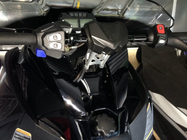

Here's a pic of my 2015 Viper R-TX-DX dash area. As you can see no switch for the seat heater present in the expected location. Talked to my dealer today and he said Yamaha wanted my VIN is investigating and will get back. I was able to easily pop out the mesh grill just in front of the steering column and I reached around under the plastic dash area where the switch would be and there's no lose switch hanging there. There are 2 holes about 2" in diameter under the mesh that may be openings that wiring could be routed down to the chassis. I reached in the hole on the left side (as seated) and there seems to be a female connector that is not connected to anything. So that may be where the switch connects and it's just not there. So thanks for all the help verifying the switch location. Now it's up to the dealer and Yamaha.
I also fired up the dash and checked the function buttons and the seat heater switching does not appear to be moved to the dash switching.

For some reason my last response posts were deleted and nobody contacted me if there was and issue. But anyway, My dealer contacted me and said Yamaha believes there was an error (the switch location was not moved from 2014) and they forgot to install the switch. Yamaha is sending a switch to the dealer and the dealer will notify me when it arrives and arrange an install. Thanks for all the inputs and info.
