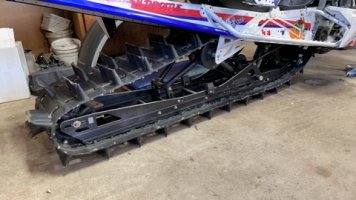

Got the second anti stab kit installed fits perfect. Ran sled thru the stroke of suspension. Gets close but doesn’t touch as far as I can tell.
Also pulled the front apart to replace worn bushings and had to do some aluminum welding on the frame that the steering column bolts to as it was cracked and the hole was oblonged.

Mainway solutions bell crank bushings.
Had to do some fixing so figured I’d do this while I’m in there. have the grease ale a arm kits I’ll do this summer.
install was simple. And perfect. the bushings fit in perfect. I put a little anti seize on them. mused a bearing driver on the bottom one first. And tapped it in with a good sized rubber mallet.
than I used a bolt and some washers as a puller to pull the top one in.
Pics to follow.
Pics to follow.
