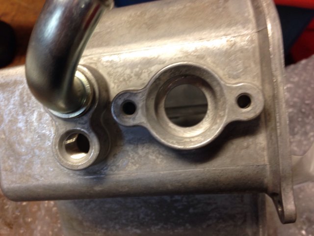

I cleaned it all off. Installed a forth wheel kit, flashed it up on the stand to adjust the track, and it was wet again the next dayRemember that there is 3 different versions of covers.
14-Thin Tab
14,15-Thick Tab
15,16-Dipstick Version
If we want to fix possible problem it would be best to know which version. I assume all 16's have dipstick version. Let's figure this out. I know gasket is also different maybe some oil gets between ledges on gasket and eventually seeps out. So starting from clean how long before oil spot appears?

Thanks a lot That's an awesome thread! It will be going to the dealer for the warranty work. I hope they at least use some three bond RTV sealant with the gasket. I used to use that on the valve cover gaskets on our motocross bikes and never had a leak!If its Chaincase oil I am afraid someone is going to have to take it apart and at least inspect that gasket. Here is thread on how.
http://www.ty4stroke.com/threads/chaincase-removal-and-inspection.130877/
Its the thirddesign so that tells you something. I keep a spare tank and cover at home just in case I screw mine up when taking it apart for gear changes and things. Think of your Grandmas favorite Porcelain dishes. They are very fragile and can be lots of things to go wrong if you are not very careful.Does anyone know why these things are leaking?
Bad gasket? bad design? Incompetent combine builder assembling my $17,000 sled? WTF?
I never had to use sealant on gasket. On oil tank the recommended sealant is Loctite 5699 Silicone. Its a bit less runny than the ThreeBond.Thanks a lot That's an awesome thread! It will be going to the dealer for the warranty work. I hope they at least use some three bond RTV sealant with the gasket. I used to use that on the valve cover gaskets on our motocross bikes and never had a leak!
