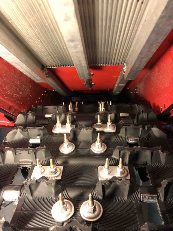

So this is 144 down the middleLooking to stud my track on the new SRX LE with the 1" ripsaw track , any ideas on what anyone used on latest sidewinder? Quantities and patterns?
With square backers. These studs have 9000 miles on them. So the backers have moved. Round backers would look better but we all
Boosted up out front so we don’t have time to care about the looks of stud backers.
I’ve done 3 sidewinders like this and everyone loves the trailability and traction. Obviously if your ice racing you’d have more.
Aslong as you stay out of the center inch of track you can run three tunnel protectors. ( 9000 miles on the one in the pic.
* don’t forget to use loctite and make sure every stud is sunk well into the track.

I would straighten the twisted ones have had them tear that way.

To be honest I think I installed them like that. After about 50 studs you stop worrying about holding them straight.I would straighten the twisted ones have had them tear that way.
Aslong as the stud is tight sunk in the track I don’t disturb the loctites

Joe, that is the reason most guys hate square backers....they turn, and then they will bend or cut into the track(sharp corner) sooner or later, I ran square long time ago and saw that.
Round is easier for OCD too...haha

Great info tx JoeSo this is 144 down the middle

The backers turning doesn’t hurt anything. 9000 miles not one pullout. Speaks for itselfTo be honest I think I installed them like that. After about 50 studs you stop worrying about holding them straight.
