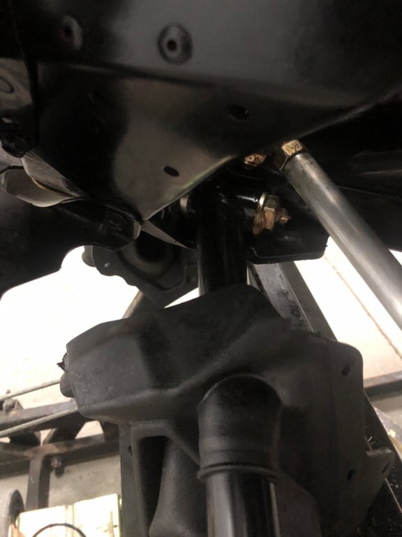

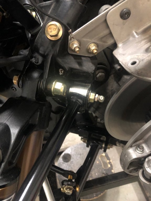

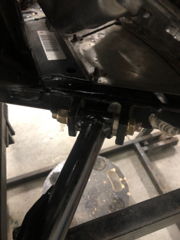

View attachment 151264View attachment 151265 View attachment 151266 View attachment 151267
Also put grease able bushings in front end really nice pieces I’m not advising for him just showing what I did.

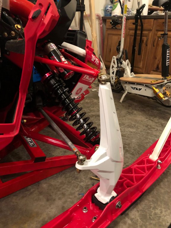

What does the extra height from the front end do to the back end ,like lift the sled off the ground and lower it to see if the track touches the ground flat not just at the back and more pressure on the rear spring letting it bottom out easier?I got the new 2020 parts for the front end and put them on. It was good timing as I had my shocks already off to be rebuilt.
Looking forward to see what type of improvement this may make as already liked the front end.
