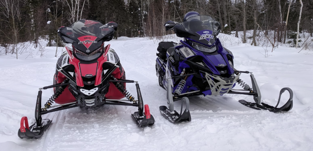

I realize that this thread started out discussing the changes/improvements made to the 2020 model front ends but since it's recently steered towards flat handling I thought that I'd chime in with a few thoughts.
I totally agree with what KnappAttack just commented on concerning Ski Doo's "improved" front end on some of their 2021 models. I talked to a friend who was riding with Mike's buddy last Friday who had the new demo 850 model and he pretty much echoed Mike's comments about the new Ski Doo front end.
Back in 2017 when I started building my SideWinder I was able to pick up a Z-Broz 45" wide stance kit from someone I know that had a spare kit available. This kit consists of wider stance A-Arms along with longer tie rods for the steering. With a set of Custom Axis shocks bolted on to the sled this has become the absolute flattest cornering sled that I've ever driven. Anyone who's ever driven my sled has made similar comments.
When Yamaha first introduced the Apex models back in 2006 Mountain Performance made some 45" stance A-arm kits for them, and I installed their kit on my Apex and it really improved the handling and flat cornering abilities of that sled. Their kits for the Apex's are still sought after by the Apex fans. Mountain Performance has gone by the way side but I thought that I heard of a Canadian based shop that was making them again.
Now the bad news for us SW fans....Z-Broz discontinued making this 45" wide stance kit a few years ago due to lack of demand. Their intended market for the kits were for Hill Climb and Hill Cross racers. I believe that the 45" center to center of the ski stance is also too wide to be considered legal on most trail systems. A 48" stance to the outside of the skis is considered the legal norm for trails in most states/provinces, and that's what the OEM's have to deal with to sell a legal sled that complies with the regulations. With the 45" wide stance kit this brings the outside stance of my sleds to about 52" using the SLP MoHawk skis that I've got on the sled.
I was able to find a used Z-Broz 45" wide stance kit last summer on a web site that I installed on my wife's 2018 SW. After her first ride this season she's already commented on how the handling has improved and doesn't show any signs of unwanted ski lift in the corners. She's not a real active rider and hardly ever leans into a corner. She just sits upright and points the sled into the corner. I followed her on a recent ride and she looked a lot more comfortable going deeper into the corners at a greater speed than I've ever seen her do before.
I'm pretty sure that 45" is the maximum allowable ski stance used in the Soo 500 Enduro race where the highest cornering speeds along with flat cornering are two traits that every racer is looking for. Here's an interesting link to an article about a sled that the Arctic Cat race dept. built a few years ago for the Soo 500: http://www.arcticinsider.com/Article/Up-Close-2015-Soo-500-Winning-Arctic-Cat-ZR6000R
I'd like to ride a 2020 SW with the new front end so I could directly compare how it handles/corners to my sled with the wider stance.
Later this spring I plan on talking to an aftermarket company that I've dealt with for years about the possibility of them building a 45" stance kit for the SW/Viper models and will post any news if they are interested or not. Since the stance is too wide to comply with the current trail regulations I suspect that they might not want to go down that road.
I wanted to share this info for anyone that's interested in what I've found to be the flattest cornering set up that I've found for the SideWinders. There's got to be some of the Z-Broz kits still out there if anyone would want to consider one. Keep checking different websites like I did and you might be able to find one. Forty Five is where it's at in my book.
