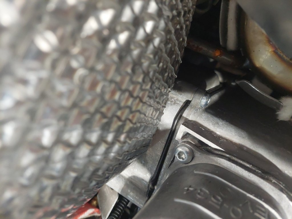

My buddy went to the cat dealership which is only 1 mile away. He inquired about what sealant to use on his 17 RTX motor oil leak. They offered a new sealant for $90, supposedly very thick and much better then the Black silicone that many are using! He bought the Black from them for around $10 he said.I have a 22 srx in for some hurricane goodies and taking a close look for any updates.
I notice they used a harder sealant like loctite 5900?
Definitely a different compound then 17 to 21
View attachment 164433View attachment 164435
So yeah, they have a new sealant for sale!

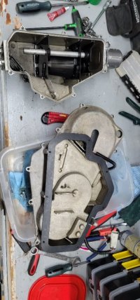

I just put in the oil tank gasket, i was a bit surprised to see how wide it is and how it folds over when tightening it, but if it works, it works lol.So.....should I install the BOP oil tank gasket I have in the ready or pickup some of the new sealant? I have not pulled the sled out of the trailer yet but noticed what appeared to be a small oil stain in the trailer deck directly below the oil tank. I'm at ~380 miles and yet, I also purchased the oil tank bypass kit. Yes, still in warranty.

I trimmed some of the excess off after I got it put together and torqued down

I resealed my buddies 21 T-Cat oil tank that was leaking. I used the gray GM rtv that they use on there Dura-Max oil pans! Don't know the part# off hand, it's a little pricey but definitely does the job! When I put on a flat bottom oil pan on my 15 D-Max I literally had to get a 2ft pry bar to get the stock pan off the block!
HABS 1
- Oct 22, 2015
- 602
- 118
- 828
- corunna,ontario
that grey rtv i believe is meant for aluminum,flex n torque wise,more durable,pwc gyes use it on the paper part of the 2 piece head on 2sks , works great, but i think if mine develops a leak the bop gasket is the way to go , just need to order it n have handy , sounds like a matter of not if but when that will leakI resealed my buddies 21 T-Cat oil tank that was leaking. I used the gray GM rtv that they use on there Dura-Max oil pans! Don't know the part# off hand, it's a little pricey but definitely does the job! When I put on a flat bottom oil pan on my 15 D-Max I literally had to get a 2ft pry bar to get the stock pan off the block!![]()

i may do that as well, but for now ill leave it as is. It may help identify a leak later, who knowsI trimmed some of the excess off after I got it put together and torqued down
