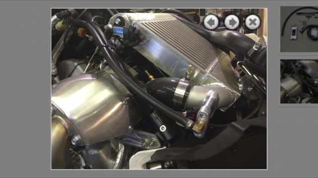

i don't have a turbo but I read all the posts about them and darn it if I can't figure out what you all mean by a "4th injector". Wouldn't a 3 cylinder motor have 3 injectors? I'm clearly not understanding something and any help would be appreciated. Thanks!
The Turbo guys are running out of fuel with stock setup and bigger power. They add a 4th injector to give additional fuel. Basicly like a Primer for topend. They put that injector in the intake or intercooler.

So they add fuel to the air intake? Do they just cut a hole and mount the injector there? I'd love to see a picture if anyone has one. Thanks!The Turbo guys are running out of fuel with stock setup and bigger power. They add a 4th injector to give additional fuel. Basicly like a Primer for topend. They put that injector in the intake or intercooler.

Read Mrsled's thread in the stickies on going to 12psi. There's pics in there of the 4th injector installSo they add fuel to the air intake? Do they just cut a hole and mount the injector there? I'd love to see a picture if anyone has one. Thanks!

The mcx kit has 3 extra injectors one per cylinder but that's 270hp
