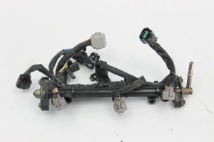

After a summer of storage, I have the 7000 back in the garage. Took a fresh look at it, and found the issue. It was the injector harness. I was twisting and tugging on the harness, there are two junction blocks where wires are connected together. when I was messing around with them, I could cause a breakdown/misfire condition. I believe I made a bit of a mistake last spring. I usually mark all of my new and used parts with a sharpie, as to not mix them up. Evidently, I must have mixed them up on the bench, and put my original harness back on the sled instead of the used one I had bought. Being used, it looked the same as my used one. I have way too much experience for such a rookie mistake. Anyway, it seems to be fixed. I will need to take it to a friends farm field when we get 2 or 3 inches of snow to verify it. I have a picture of those square blocks, if it loaded properly. Thanks to those who helped me with the ideas. I will update when I actually get to test it.
- 5,546
- 4,197
Glad to hear you got it. Those square blocks do give trouble quite often.After a summer of storage, I have the 7000 back in the garage. Took a fresh look at it, and found the issue. It was the injector harness. I was twisting and tugging on the harness, there are two junction blocks where wires are connected together. when I was messing around with them, I could cause a breakdown/misfire condition. I believe I made a bit of a mistake last spring. I usually mark all of my new and used parts with a sharpie, as to not mix them up. Evidently, I must have mixed them up on the bench, and put my original harness back on the sled instead of the used one I had bought. Being used, it looked the same as my used one. I have way too much experience for such a rookie mistake. Anyway, it seems to be fixed. I will need to take it to a friends farm field when we get 2 or 3 inches of snow to verify it. I have a picture of those square blocks, if it loaded properly. Thanks to those who helped me with the ideas. I will update when I actually get to test it.
