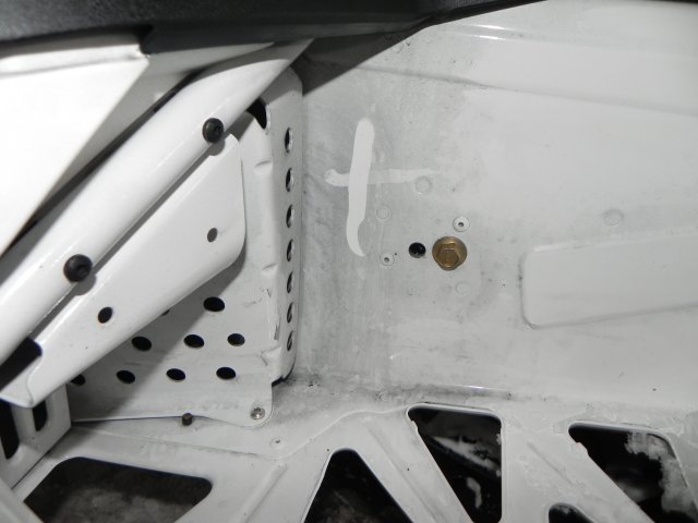

here's a pic at 700 + kms I haven't cleaned it yet
wavemaster
- Mar 6, 2009
- 476
- 171
- 738
- New Hampshire
- SR Viper XTX, Nytro XTX, Phazer FX
8DN from new. 650 miles (about 1050Km). 2015XTX SE
Mine was worse than Yamamarc with 8DN and less miles. I have 500 total now. I went into a 200 mile or so jaunt with some testing and had dust everywhere including the back sides of my hand grips.
