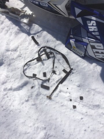

One slightly used 8jp belt for sale. This was on a turbo, 2nd one that blew last year, both belts were used belts that had miles on them but only lasted 200 miles on the turbo. First season, all stock with a clutch kit I had great luck with the stock belt, no weird speed issues or inconsistency, swapped out first belt at 500 miles just because and the second one went the rest of the season with 1800 miles and the last ride of the year it was up over 100 mph, but granted it was on a stock sled, the 8jp isn't holding up for me now with the added power, I finished out last year with 800 miles on an 8dn, no it doesn't look new, it's certainly showing signs of wear, but 800 miles on a 200hp machine with a lot of hard launches every time in ride it, I'm more than happy with that. With the 8dn and 8jp on mine with the turbo I felt zero difference in performance, and we ran a full day doing back to back testing with a radar and timers and neither of the belts stood out as being better as far as quickness or top speed, the 8jp just wouldn't hold up for me.
