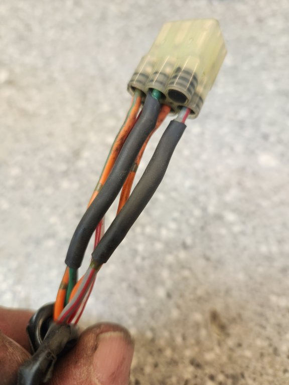

Good job!!Well dug into it tonight. Found two wires from the coil harness that were rubbed into. Repaired them and looked into why they did that. A little clamp was rubbing on them and I guess once in a while they would both touch the clamp and cause the stumble.
View attachment 172259View attachment 172262View attachment 172261View attachment 172260
