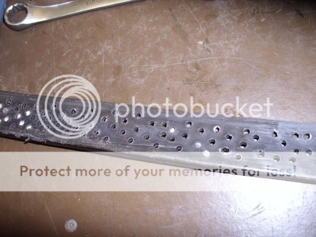

The other thing I forgot to say was have you ever drill holes on your sliders to let snow into the holes to help with cooling them.

Drilling holes in your hyfax is not a good idea... one if it where they would come with holes allready in them . It takes away surface area and it allows dirt to fill the holes and wear your track clips out way sooner. Plus I have seen where it allows dirt to inter and compact around the slide rail itself making it very hard to slide them off to replace. This is something OEM's tried years ago and found it did not work.
heat exchange
Hey Rich what you are saying makes sense to me after all I am removing lots of hyfax when I drill all the holes in it.
I have tried it and I think that it real comes down to where you ride .Hey if I was sledding in new snow every day and not running roads to get gas or up the road that gets me home they would last almost forever.But from what I have observed is that the hole fill with snow /ice and when they get hot they release the snow and giving the lubrication that is missing.
I am not saying that it works in all condition but for me and the area I ride(Ontario)it has more then doubled the life of the hyfax.The reason I tried it the first place was the way I was going through 5 sets of hyfax each season of 5000 kms/3100mls.

wow that's a lot of work. don't have that kind of time to sit there and drill all those holes. IMO, bigger idlers and marginal wheels work great and a lot less hassle.

I tried the drilling holes in sliders trick a few years ago...didn't work for me. See my post here: http://www.ty4stroke.com/viewtopic.php? ... les#545562
