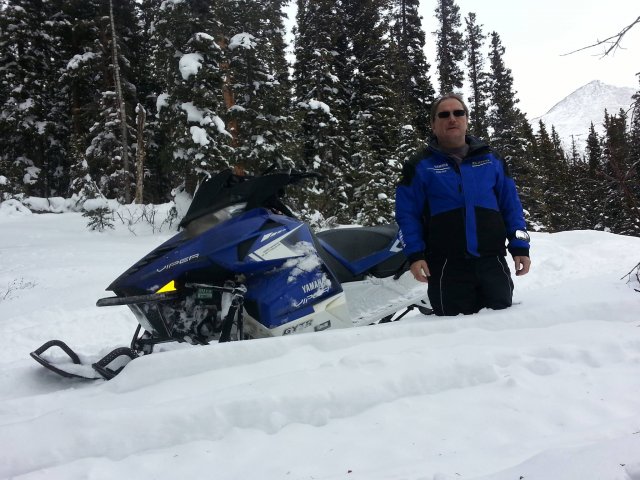

Another day of riding butt deep powder and NO steam from either of our Vipers. I jumped off my sled so girlfriend could take a pic...no steam but no radiator either. Oh, no steam on hers with the radiator fan reversed.
