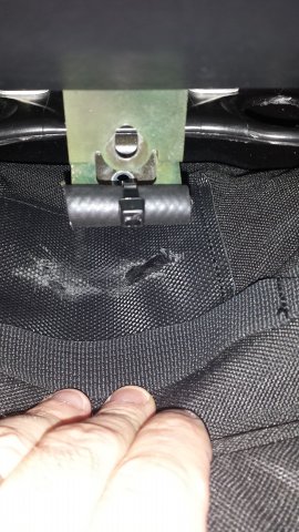

I epoxied a piece of rubber in that area. That really helpedMine wore a hole from the rear latch, be careful for that.
