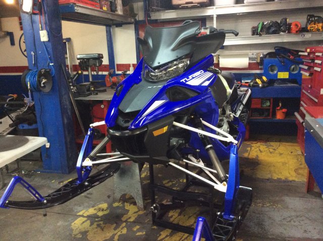

nice....Im patiently waiting got OSP ...they have a guage mount with no drilling etc....and soon to have an exhaust!
Epicsw
- Sep 27, 2016
- 196
- 84
- 253
- Fort Atkinson
- 2017 Sidewinder
That is SO cool! Wish I was that handy!
