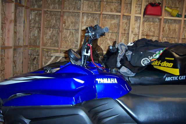

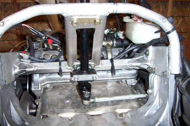

Well I took a shot at moving my column. Turns out to be pretty simple. No money spent and a few hours work. Remains to be seen whether it will hold up. It moved forward about 4 1/2 inches and didn't require too much hacking, and I could switch it back without too much trouble. I used all existing parts except for a couple little pieces of steel stock. If anyone wants more detail PM me. I obviously have too much time on my hands!
A couple more pics competed
Looks pretty solid. Now maybe route some guages down to fill the hole in the fuel can cover??? 1 more thing to do this summer.

That looks great, I would like to see some more info on it. It looks almost too simple, running the post thru the support like that.
Lance
I was so impressed that I ran right out to the garage and started tearing it apart. I assume the steel stock you refer to is the angle cut pieces to mate the post blocks with the support column?? I wonder if there is a way to raise the entire assembly as well while you are doing it?
T
Are you cutting both the hood and the tank shroud?
Is your post a taller than stock, or does it just look like it after it was moved?

Hmmm............the large hole left over where the steering column used to go through would make a nice place for an oversized Boost guage . ;)!
Man, that's sweet. Looks like the Genesis II chassis to me. Probably all Yamaha did was that mod, Vector front end and fuel injection. Looks to me like the guage pod might fit in the old hole if you moved the ignition to the other side and cut out for the pod. That would be cool and you'd actually be able to see the guages. Man, I wanna do it!!!! You should post this over on the RX shorty threads. Those guys would love it too. Nice way to get rider forward without shelling out $10,000.
