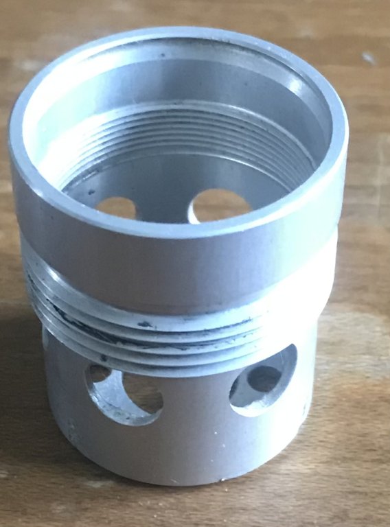

I would love to talk to you about Öhlins and Tundras sometime. Never knew. Glad you still are around here!I kept one adapter in case Ohlins stopped producing them. If they have stopped, it should be easy to whip a few out at this point… I have the numbers for the compression adjuster. The adjuster is fairly standard across many dampers, just shims and spring may require changing.
