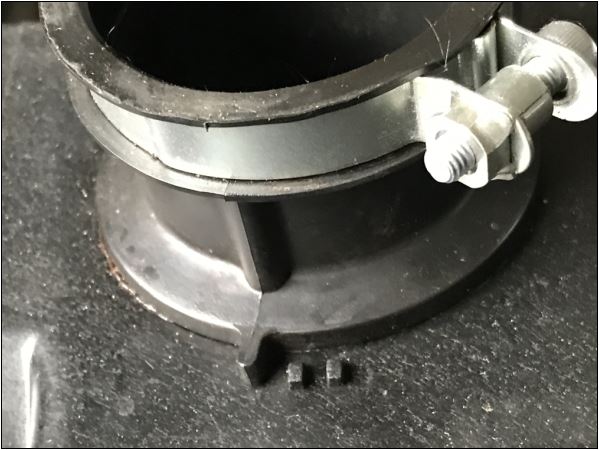

If I'm not mistaken, at least on my 08 Apex, not only is there a notch for the hose clamp to position correctly, but I also thought there was a notch on the air box for the intake boots to be positioned correctly. I currently have the air box off and will have to confirm this when I get home tonight

Yes there is a spot in the clamp where a little rubber tab on the boot fits in to align it.

Correct, but I also thought there was a tab on the air box where the rubber boot is suppose to fit into. My comment was in reference to jagabom spinning the boots so that the allen head bolt on the clamp is closer to the top. Just as I thought the clamp needs to be aligned with the rubber tab on the boot, the boot needs to be aligned to the tap on the air box. Again, I could be wrong and will check but wanted to throw caution to re-positioning the boots.

Here's the notch on the air box I was referring. Whether or not there would be an issue spinning the boot to orient the clamp bolt closer to the top remains to be seen but I was fairly certain there was one. Although Yamaha probably had a good reason to put that notch there, I'm not really sure there would be problem with rotating the boot like jagabom had done.

with the right tool there is no need to rotate them so I never did.
jagabom
ThanksRobX-1. Didn't know that.. I also don't know if the 1/8 of so of a turn will cause any problems. For my easy riding style, i don't think so.
