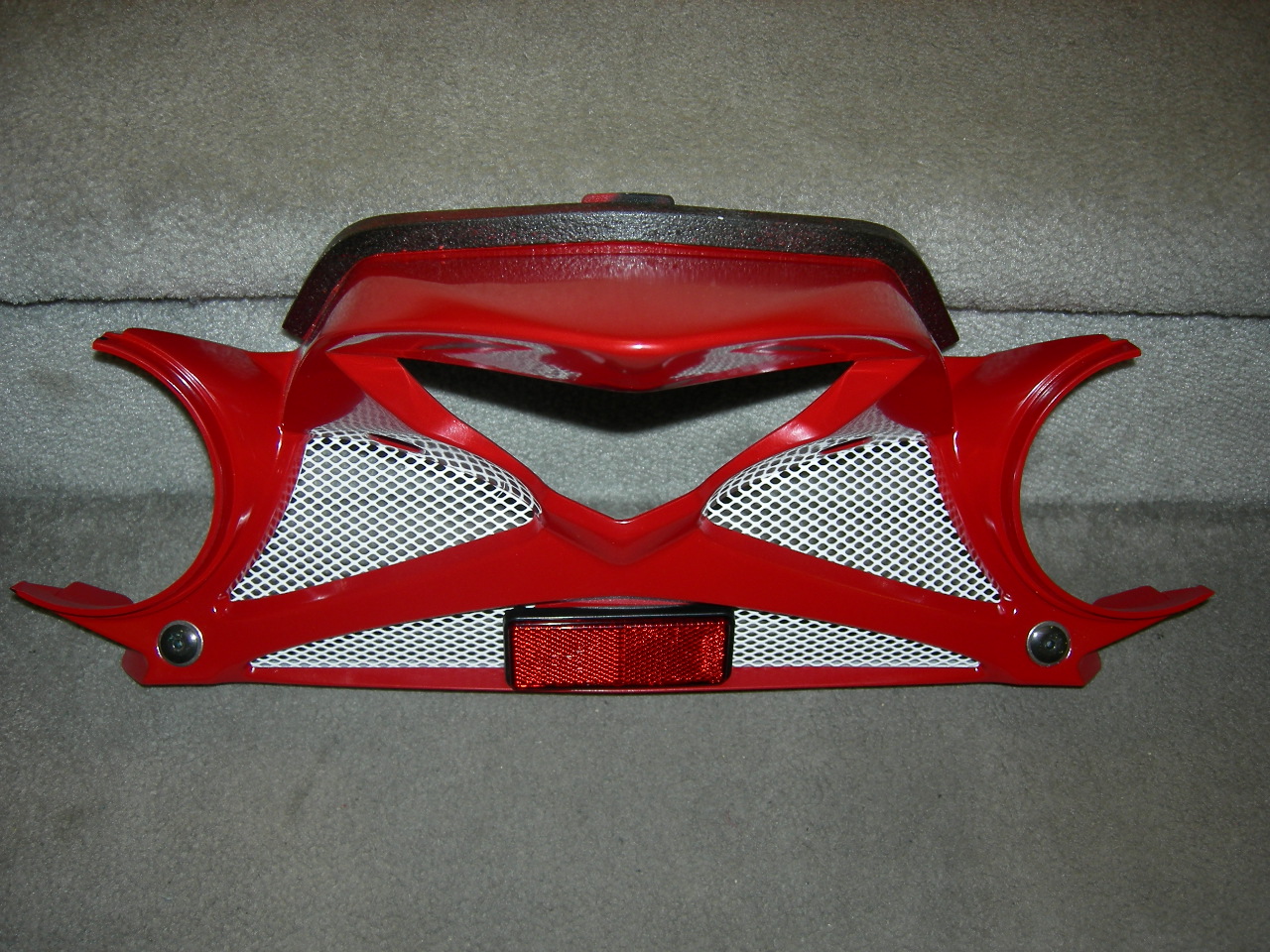

No drilleing required. Remove exhaust tips first and then the whole plastic piece (the one with the metal screen in it). After that the two 10mm nets that hold the seat down will be easlily accessible.
Yamaha Man
o ic, so the plastic piece in the back (the one below the light) will pop out??? I unscrewed the two screws holding it in, but didn't tug on it or do anything cuz I thought the two rivets were holding it in.
Yamaha Man said:o ic, so the plastic piece in the back (the one below the light) will pop out??? I unscrewed the two screws holding it in, but didn't tug on it or do anything cuz I thought the two rivets were holding it in.
It just pops out. The rivets hold the reflector on.

remove the exhaust tips as well not just the two screws...
