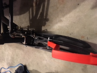

The wheels up front are an anti stab kit I bought many years ago from HPE....the wheels are hard like roller blade wheels.

I changed from the Yamaha Tuners to Kimpex Arrow II skiis. I have had 4 different sets of skis on my Attak since I got it.
-Stock skis
-Simmons Flex Gen 1
-Yamaha Tuners
-Arrow II
The Arrows are my favorite so far
I had cable scratchers on my suspension and had issues with them moving and loosing tips even when Red loctited.
I went with ski mount scratchers and they have worked well for me.

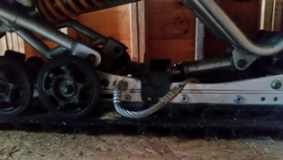

We've had the Duraflex Cables.. on the Attak up closer to the wheels.. never a problem. First ones had issues I've read. There is a right and left to them when installing. I leave them down alot due to the hyfax issues on my attaks. In and out of the trailer with cleats on the door ..same goes for my shed ramp at home when I ride from there. over railroad tracks you name it.. they are the best since sliced bread.
I first bought the marginal wheel kit at the bend then another kit in the middle of the rail. THE BEST PRODUCT...PIONEER DROP DOWN KIT. Unfortunately, they do not make this kit that replaces the 6 wheel mounts and drops the stock wheels down. I wish someone would make some more kits. No more hifax wear.

I found using the Duraflex cable scratchers alot and dupont sliders like others here it solved the problem.
Agreed re the Pioneer drop down kit. Others use the Excell wheels (5mm larger OD). Both do the same thing, take some load off the hifax and decrease rolling resistance.
I have a set of the 6 pc Pioneer PS-133 Hifax Extender kit for Mono-2 suspension, if anyone is interested, PM me.
