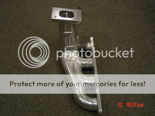

I saw that Bountyhunter posted a real old picture of my manifolds here are some new pics of the updated manifold.

Ted Jannetty
- Nov 24, 2003
- 2,010
- 1,198
- Waterbury Ct.
- www.jannettyracing.com
Probably just camera angle.
