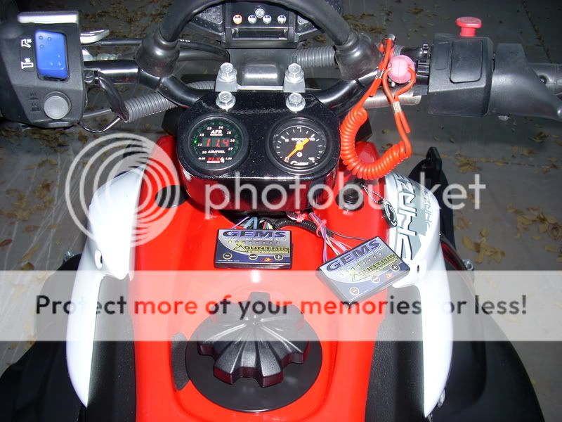

The sled runs a little sluggish at elevation with the head shim, mcx does not compensate for this mod and the system can only add so much fuel before its at its max with out changing the mapping or buying the 1k display/control unit. I now run MPI's fuel controller setup which is created both by them and pure logic which works great on the nytros. It has on the fly adjustability no computer is needed and makes life much easier-it adjusts just like a carb but digital, you adjust the low,mid and high end digitally and then it has 2 boost settings which allow you to add as much fuel needed when boost is reached. After the install it took me about 2 hrs to dial it in running 116 but needless to say it runs sweet now. Looking into different turbo setups and options now.

Im not here to argue, i know when my sled runs better and well it runs better, by the way this is not just purelogic it was created with there help, there are 2 seperate controllers installed to all the same places as the mcx system giving me not just one box of adjustments but 2, and yes here adjusting on the fly is key, 8-14k feet elevations, -20 to +50 degree riding days are not out of the usual with in a week here.

I have ridden at all kinds of elevations and temperatures and have not had to make any adjustments. Does your kit have an oxygen sensor if not I wouldn't adjust anything on the fly. It's kind of like when you jet your sled till it feels like it has the most power and that happens to be when the engine is running too lean. With a proper injection system it will automaticaly compensate for temp and alt whch is why the MC-X has a barometric pressure sensor which increases boost with increased elevation and why it is tied into the manifold air temperature sensor. Even with 2 boxes of adjustment you still do not have amount of adjustability which the MC-X has. How much cash do you have in your two boxes and boost guage and wide band if you have one?

Last time I priced out pure logic boxes they were 400 bucks a pop you have two plus a wide band and a boost guage which the MC-X comes with, I guaretee you got more than a grand sitting there that doesn't perform as well as the MC-X struff. I had a friend buy pure logic for his polaris razr which he put a turbo on and is disappointed because he can't get enough adjustment out of it. That same guy has a 2400 horse race car and he wishes he would have spent the extra cash on the MC-X ECA and display unit. And yes the kit will still compensate without the head shim.
