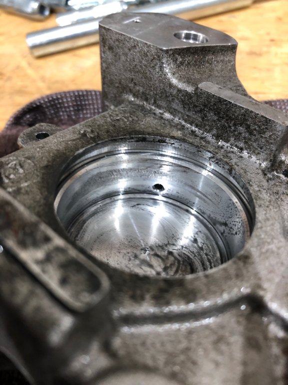

Look at the pics you’ll see what I’m talking about. Most aluminum calipers have a stainless steel wear pad and double retention pin that prevents this.
Really? ......every time I turn around it’s some poor engineering on these machines.
I have original calipers on my 1996, 2000, and both 2002 sleds I own, all have a lot more miles!

How many miles?
Are you thinking that even if the brakes don't get used much, just simply vibrating there could be premature wear?

How many miles?
No it’s not really from vibration, it’s only worn on the braking side of the caliper. I will probably cut the pads down so I can fit a wear plate to the caliper......like it should have been done by yamaha.
I’m so tired of paying premium prices for disposable junk.
Instead of cutting pads cut the Caliper is enough material. Then add some nice stainless sliders. The race pads are bigger same Caliper just machined out to fit. Was going to do that to mine but dealer got my grooved Caliper warranted which was nice since it comes with new shaft bearing.No it’s not really from vibration, it’s only worn on the braking side of the caliper. I will probably cut the pads down so I can fit a wear plate to the caliper......like it should have been done by yamaha.
